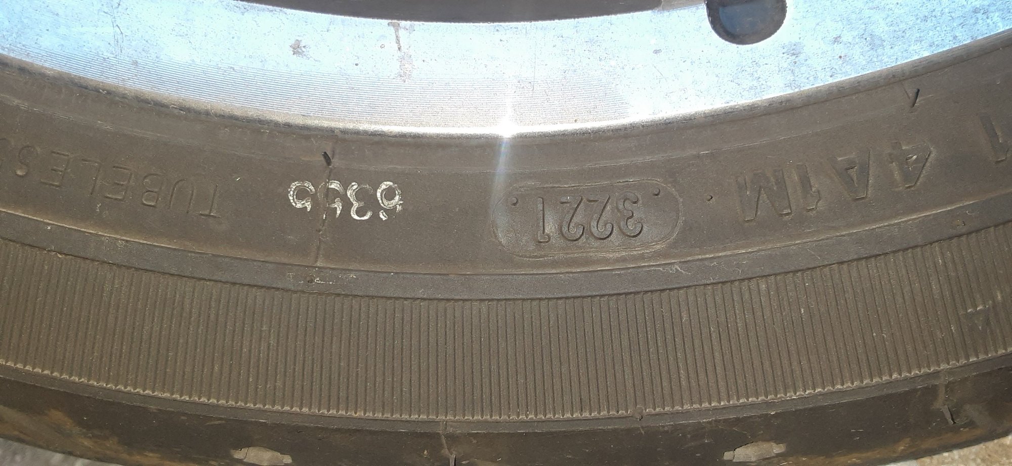

My Scooter 2016 Ultra Limited
Dunlop D408 front tire
Front tire cracked/split all the way across. Yep this is the edited line..
Manufacturer date code (2321).
Give or take 1 year old from manufacturing date.
​​​​​Installed March 2022.
Probably less than 5000mil on it.
I always keep good tire pressure never over Loaded looked over befor every ride.
Question do you think this crack/split is inpack damage?
Thanks for your time.

Manufacturing defect. That looks typical of that model of Dunlop.

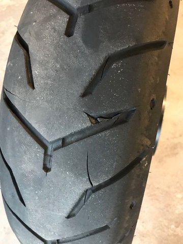

This was the rear tire on my RGU after riding it home from Chicago last fall. No, I did not run over anything.

After the third rear Dunlop tire split badly at 4000kms, I’d had enough. All I got from Dunlop was that I was overloading the tire or running under inflated. After sending the temp/heat graphs from my Tpms, I never heard from them again. I’ll never put another Dunlop on my bike.

Looks like manufacturing defect. My stock front (date code 4120) and real tires (date code 4220) have 13,540 miles so far, still good.

I discovered this morning, as I was getting ready to head out for a ride, that I have this same crack across the tread on the rear tire of my FLHTK. This tire replaced the last one that did the same defect. Dealership contacted Dunlop last time and they covered some of the cost of a new tire, so we'll see if they do it again. I've never had an issue with the front and I always ride single. Is there a better option out there?
