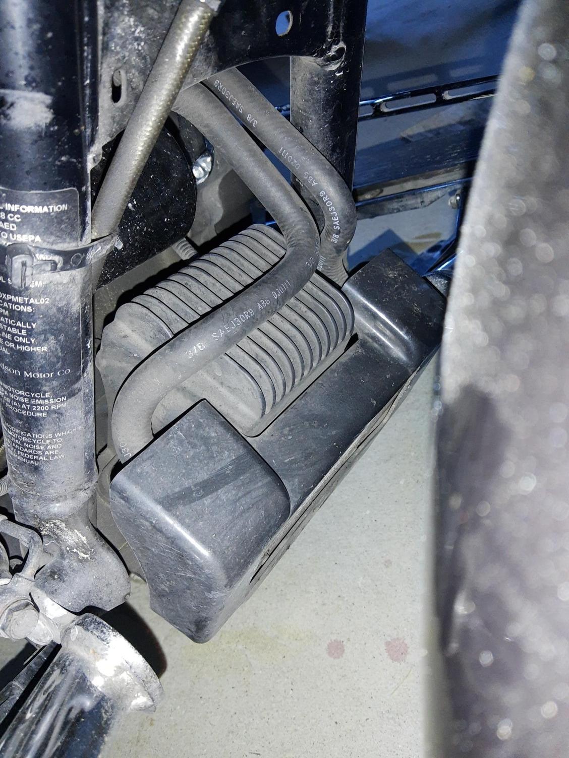

Originally Posted by Onlydad
I've read a lot bout oil coolers, looked at the various brands etc. I kind of don't like the way they piggy back on the oil filter, in my mind it just introduces yet another potential weakness to leave me stranded at the side of the road. As usual I see things my own way, I'm also cheap or poor either way same end result. I have a 2011 Ultra (103) I see my OEM oil cooler and think well, replacing that would be reasonably cheap and easy, I could install a larger unit with or without a fan or two probably for a few hundred bucks, or less... Then I get to thinking, what about cutting one of the lines or replacing--- whatever and adding a second oil cooler of about the same size to the same loop, either stacked with the OEM or attached to a frame rail, whatever..
The question is, would I create any issue interrupting the oil line and installing a second oil cooler to the same loop? Or should I just replace the OEM with a larger unit?
Any comments will be considered. Thanks. I took a shot just to help you get oriented that's the regulator/rectifier
on the top the oil cooler is below, the two lines are shown.
I might also suggest you find a different location to mount your oil coolers.
From the looks of the picture you posted you like to ride more than you clean.
I hate the low mount coolers behind the front wheel.
They get full of road grime and are hard to get at to clean.
I didn’t realize how plugged up my old low mount was till
I actually took it off.
If they are full of crap and air can’t flow through it
Then it’s just a worthless hunk of metal
Hanging on your bike.
