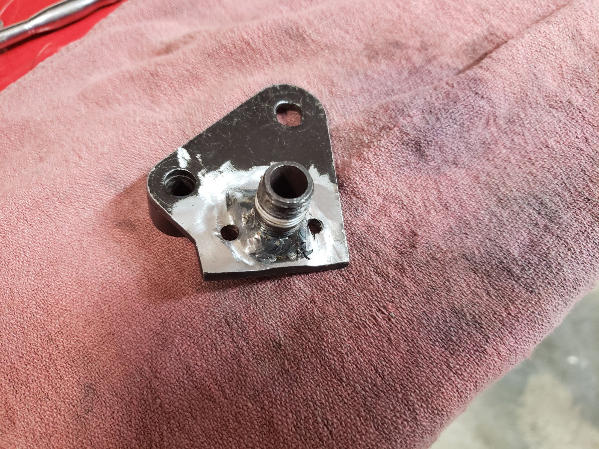

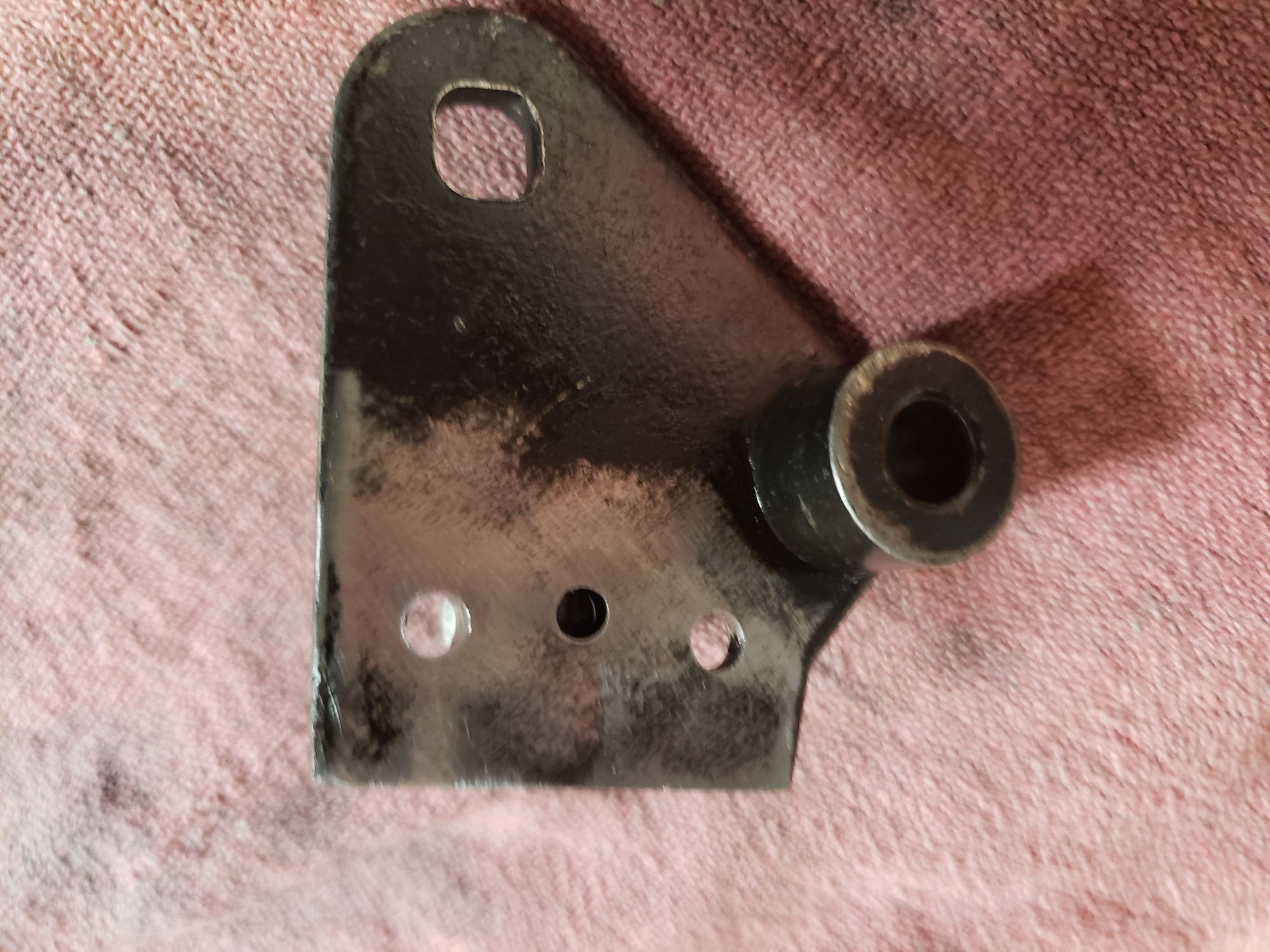

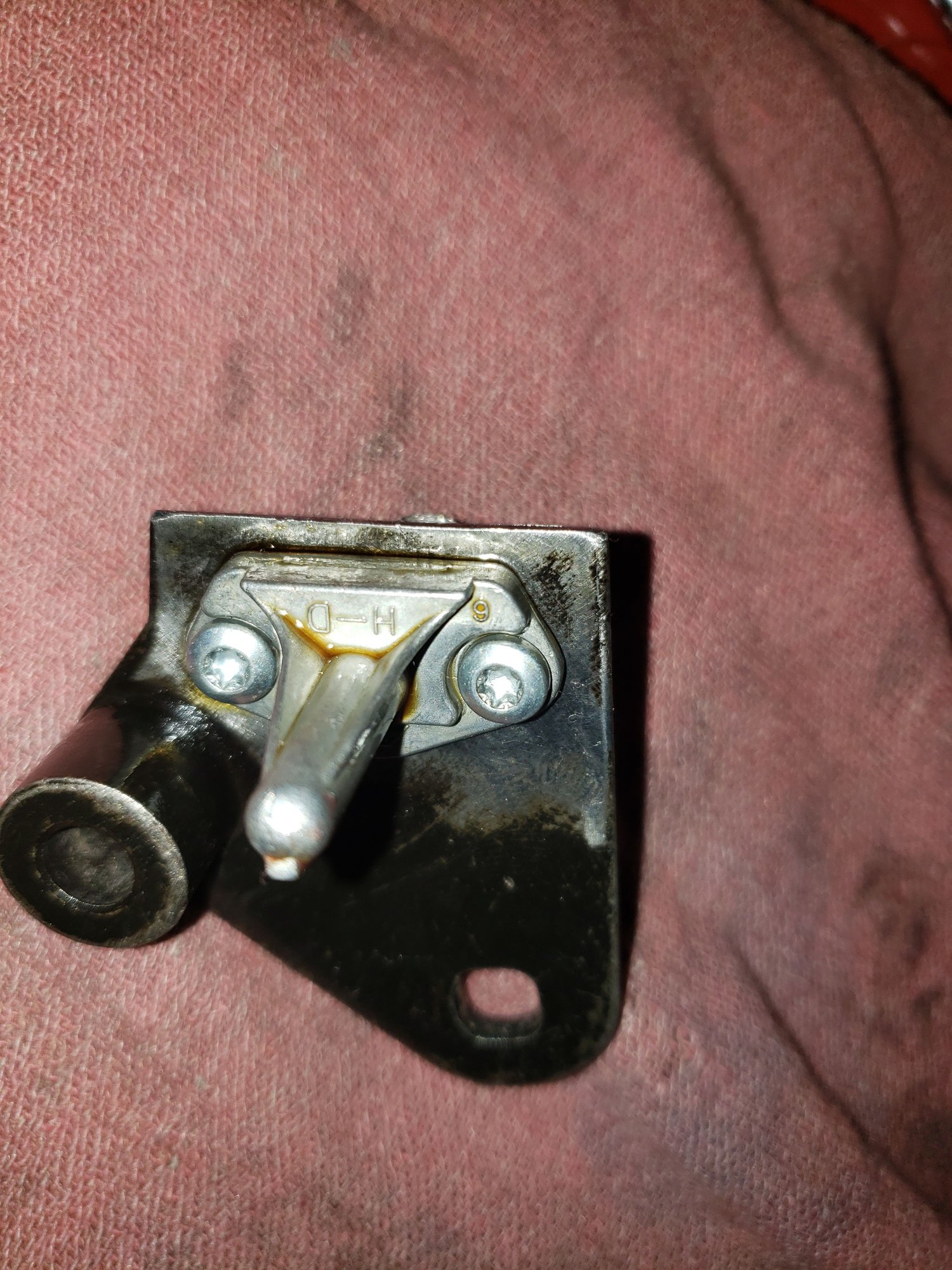

I made my own...

Perfect! $200 plus saved.
