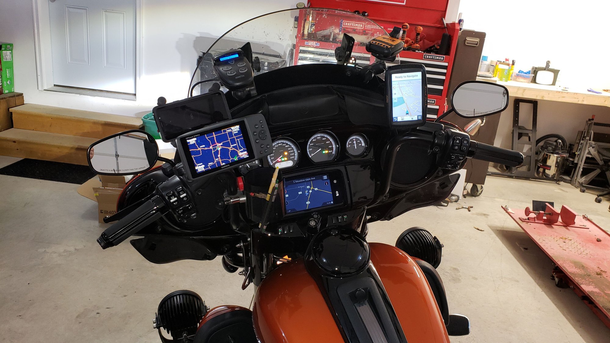

For general use, a phone with google maps is hard to beat. If you are planning longer trips with specific routes or stops, that's when the dedicated GPS starts to show its moves. The Garmin XT is the current golden child, but it uses a glass screen which, like your phone and the Boom GTS, can be affected by water.
If you are looking for a dedicated GPS, I would recommend an XT, or z590 or z595, with touchscreen that can be used with gloves. I am including a link for a HD mount that works great with the pre-Rushmore fairings (it looks like you have an '03). All the wiring is inside the fairing and the low draw means you can tie it in almost anywhere.
I'm not sure what you would be using for audio, but the z590 can tie into the stock head unit via analog plug, or bluetooth directly to a separate bluetooth headset. There are other configuration options too.
Harley Mount. It says 660/665, but it will work with anything that uses AMPS mounting (almost any GPS that has 4 hole mounts).
https://www.harley-davidson.com/us/e...Kit/p/92238-09
I don't have a pic of my pre-rushmore configuration, but I do have a bit of experience with GPS mounting and use.
