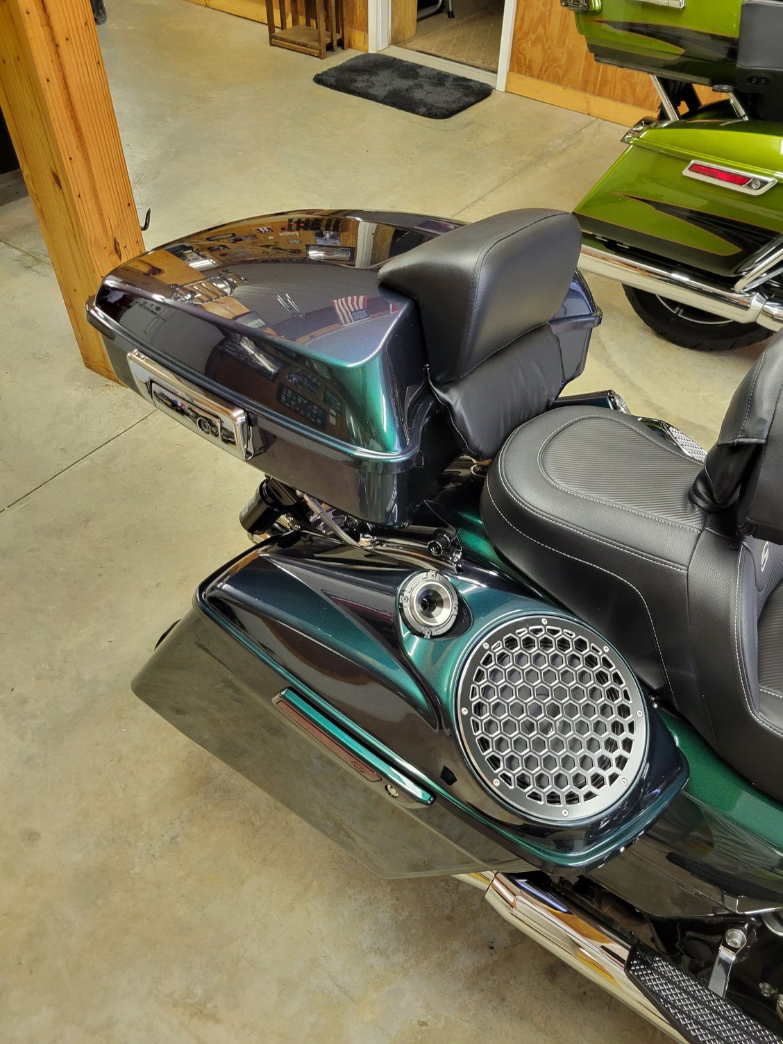

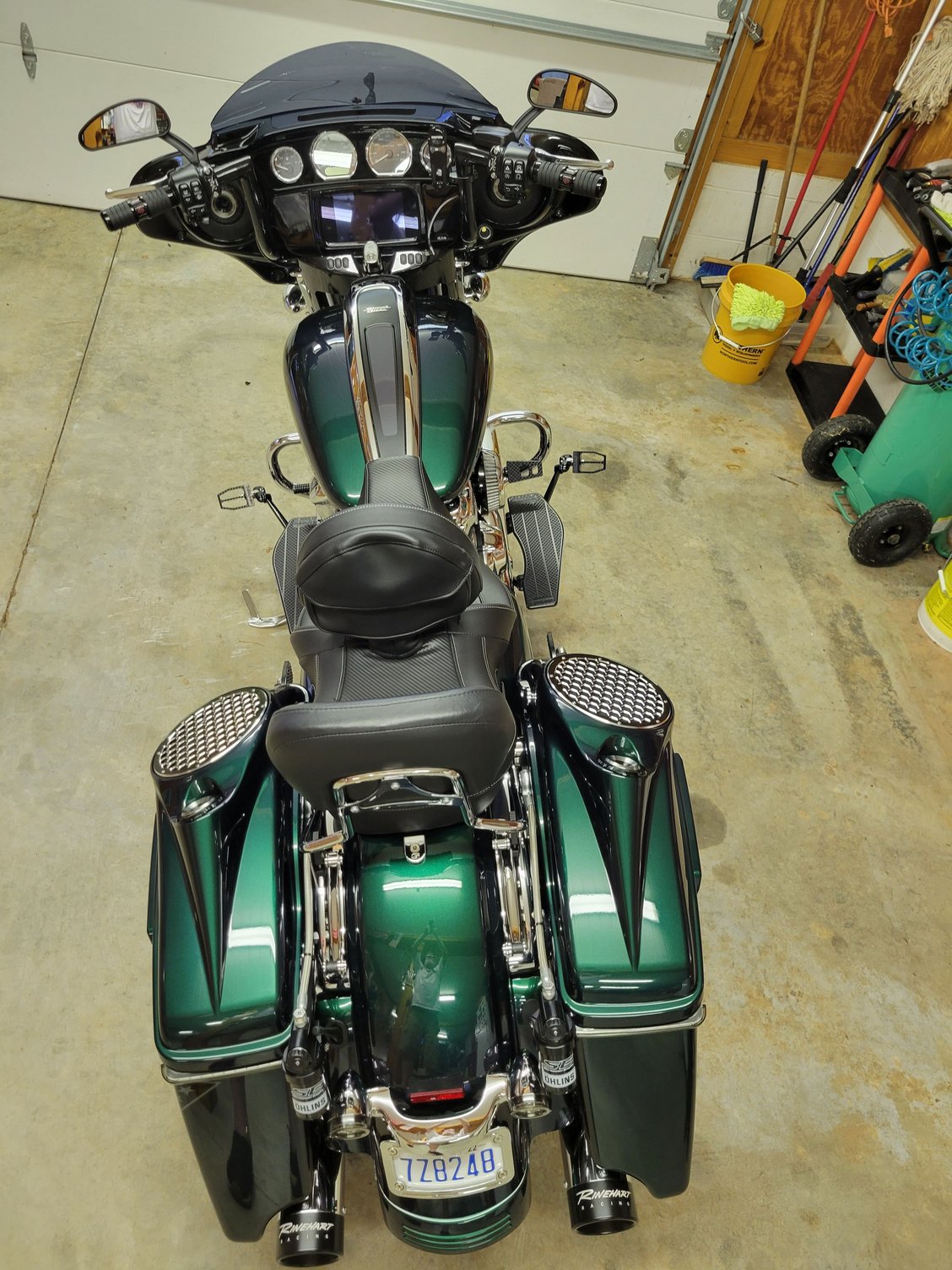

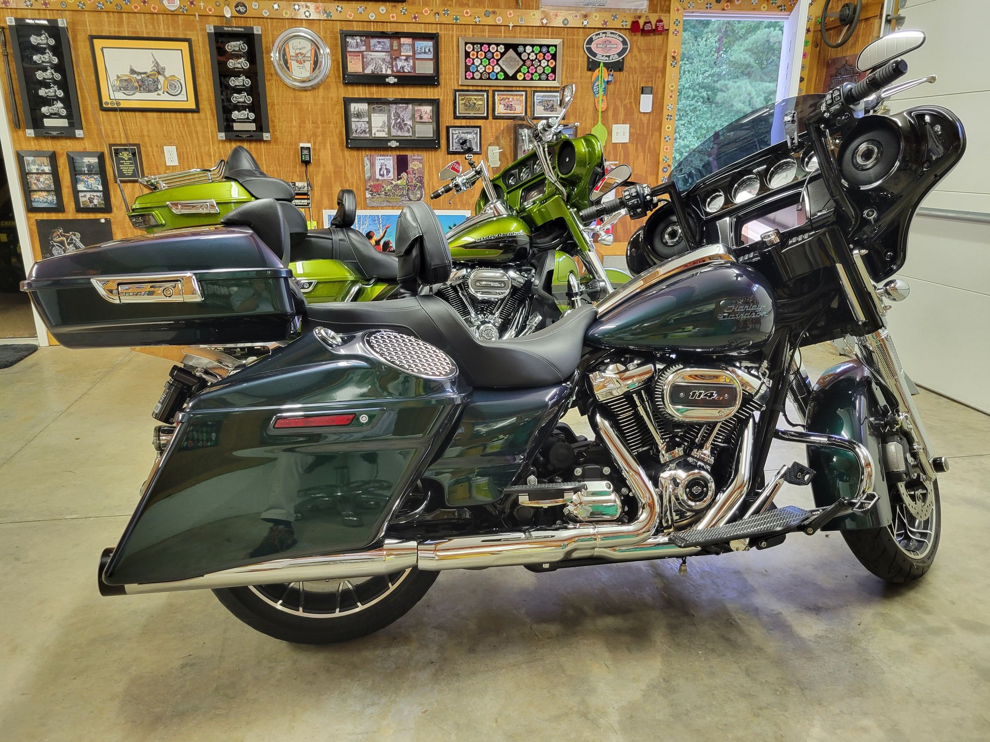

I have been a Pro-Action fan for many years now. But on our 21 SGS we went with the HD SE Ohlins and love them. My wife saw them on a bike at the dealership and really liked the look. The black reservoir goes better with our theme. When they offered me a set at 20% off I said yes. I did ask about spring rates and of course the dealership had no idea. I set them up accordingly to the Ohlins program online and they do everything you would expect. I did go with Pro-Action on the front. The bike soaks up every road imperfection with ease and handles perfectly.
I also like the brackets for the HD model.
