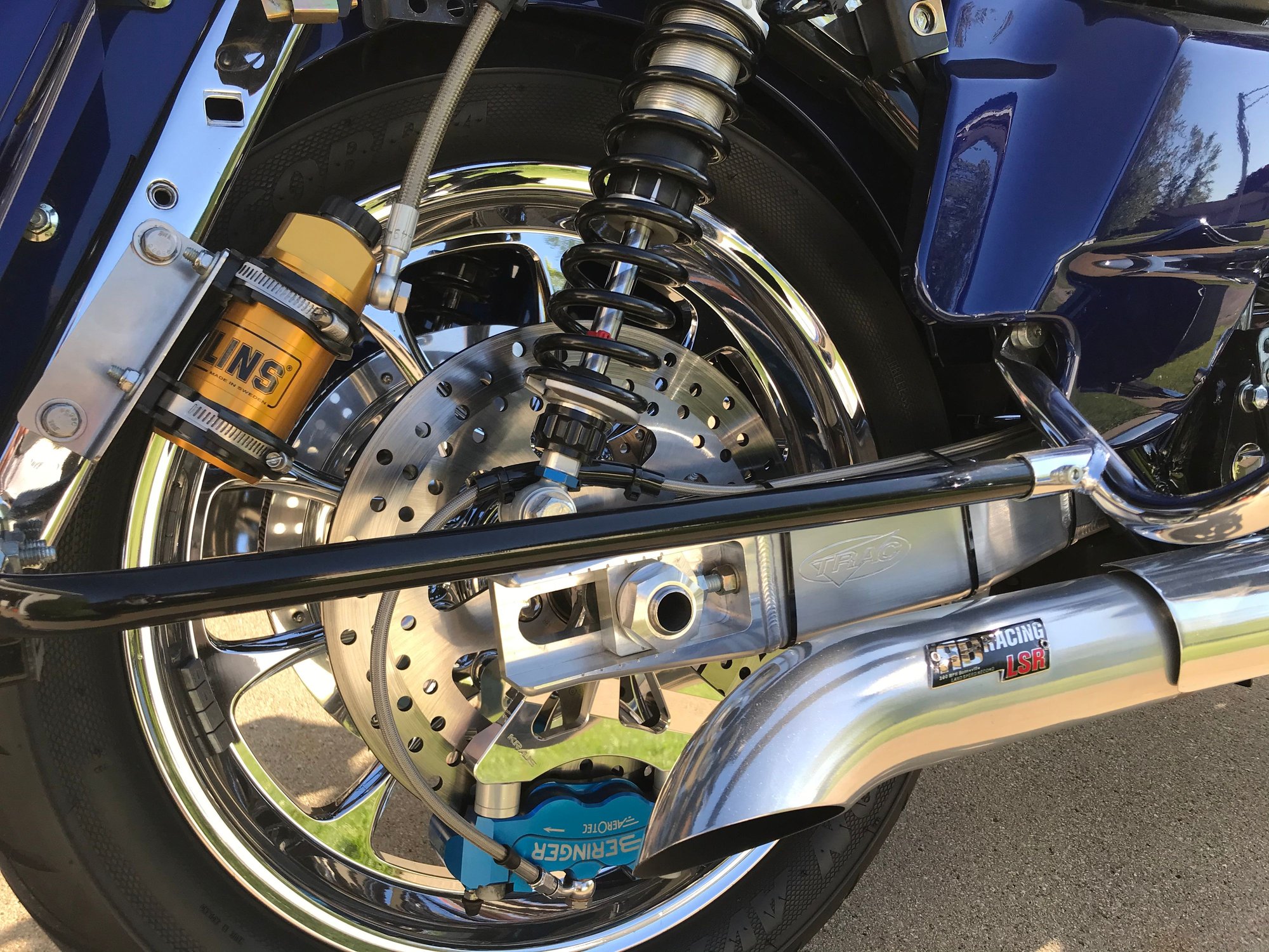

If you want a nice cushy ride a nice cartridge system with upgraded rear 13” shocks will do. I went all out on one of my bikes about 4 yrs ago
with Krause inverted front end, Rear Ohlins 357 13” shocks.
Aluminum swing Arm radial brakes and rotors and so on.
I messed with and changed front springs twice, Had the rear shocks revalved
Never could get the bike to ride to my liking.
I Suppose I expected more and never really rode the bike to its full potential.
Its better meant for aggressive riding and that’s just not my style at my age anymore.
I honestly can say my 06 ultra with the stock frontend
And a set of RWD 13” shocks on back rides better than
my 06 Streetglide with all the bells and whistles.
If I had it all to do over again I would of left it alone and saved my $
Im not sure if it would have made a difference on a newer bike or not
I doubt it.
