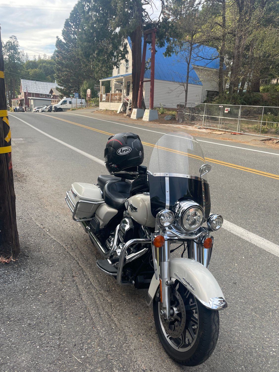

As I was ripping the twisties, all of a sudden my clutch cable breaks. Luckily I was in town when this happened and stalled the bike safely on the side road. Tried to put it in neutral but was able to safely stall it.
Now I’m stuck on CA-49 in Sierra City. Waiting 3 hours for a tow from AAA

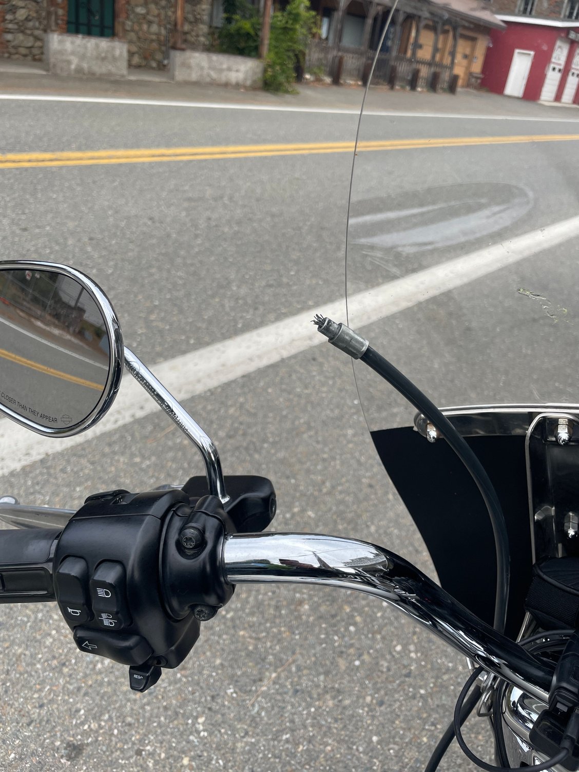

Snapped cable

Original clutch spring plate? Bowden cables will wear very quickly if overloaded, so unlike hydraulics require pretty anemic springs.
If you have a pair of pliers you could pull on the cable end and get it into neutral at least, so you can roll it around and get it onto a flatbed... but I see this happened yesterday, so hope you got it to a shop!

I would like to do a hydraulic clutch conversion if that’s even possible. Luckily I found a part at the dealership that had it in stock. Unfortunately that part was 150 for a freaking cable

thanks for the heads up, jic, I ordered new cable for '06 RK @65K. I recently changed out mini apes for "classic" bars for a traditional aesthetic but I'm thinking it might also reduce the strain on that cable end. It is definately a must look pm at this milage.
