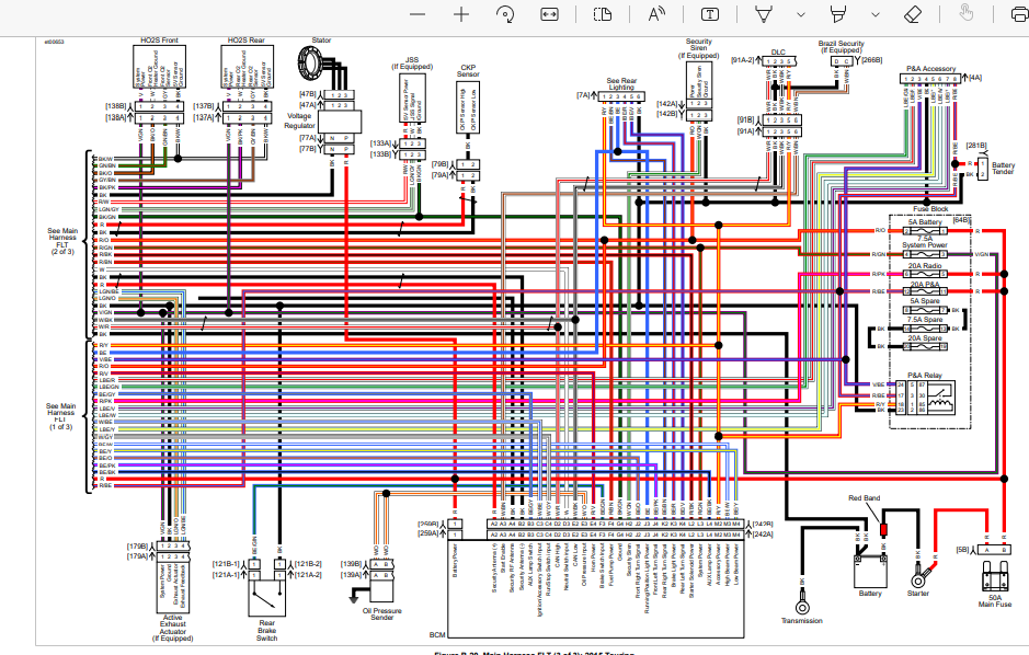

why is line 2 missing in the diagram
That end is a 7 pin connector, position 2 was the one they didn’t use.

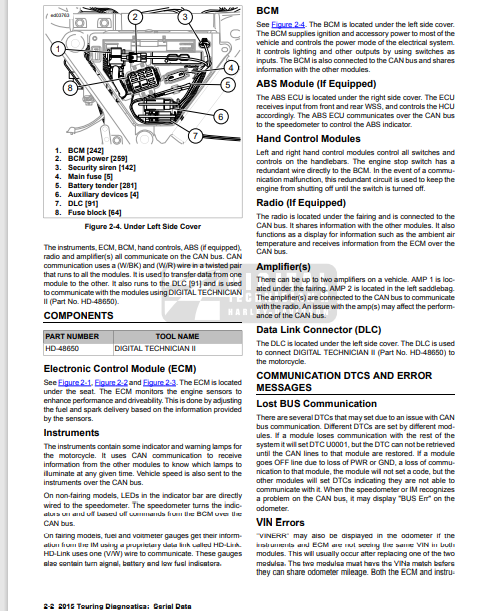

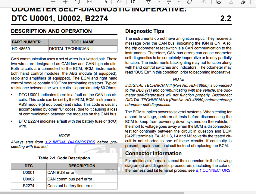

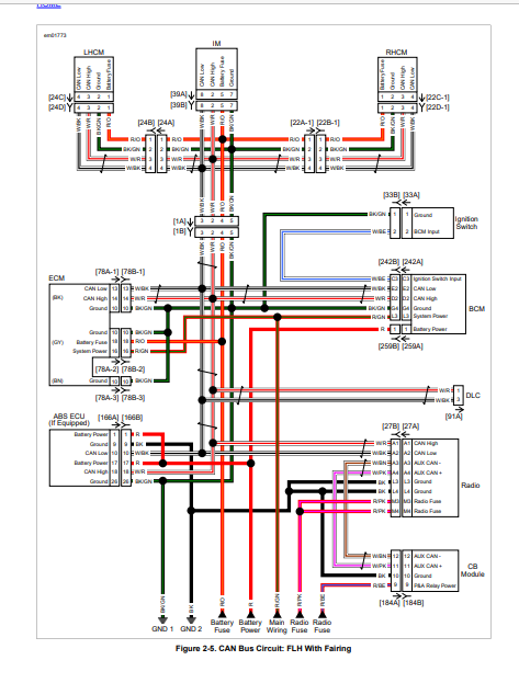

Here's a few pages from the HD Manual about can bus. In 2013 the "main wiring Schematics" took 5 pages, 2015 just 3 pages. Can bus eliminated a lot of wiring, I added the fuse box page from each year.
