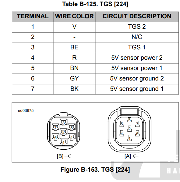

The KST are a nice bar. Good choice. Let us know how things work out. Again, if you can reuse the old cable eliminate that green plug and life will be better. Don’t dik around with soldering, there’s no need just gently remove the green plug from around the wires. The wires will easily come off and will retain their male and female connection ends. Just simply plug them together and heat shrink them individually. (Just be sure an ID the wires coming in and going out. With mine they we’re different from on side of the plug to the other.)

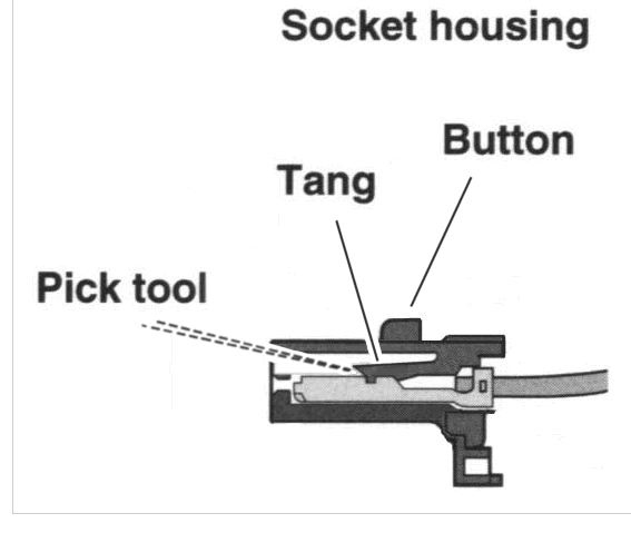

You could just de-pin the connector and replace the end with the broken latch.
If the wire colors are different take note of the placement, take a picture top and bottom both sides.
Pick tool - pin or paperclip
Take the seals out of the end and remove the pins
