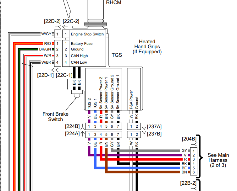

Looks like a pretty confusing cable. #1 at Connector 224 is #2 at connector 204, no 2 at 224.
I'd make sure all the pins are where they should be and seated well in the connector.
