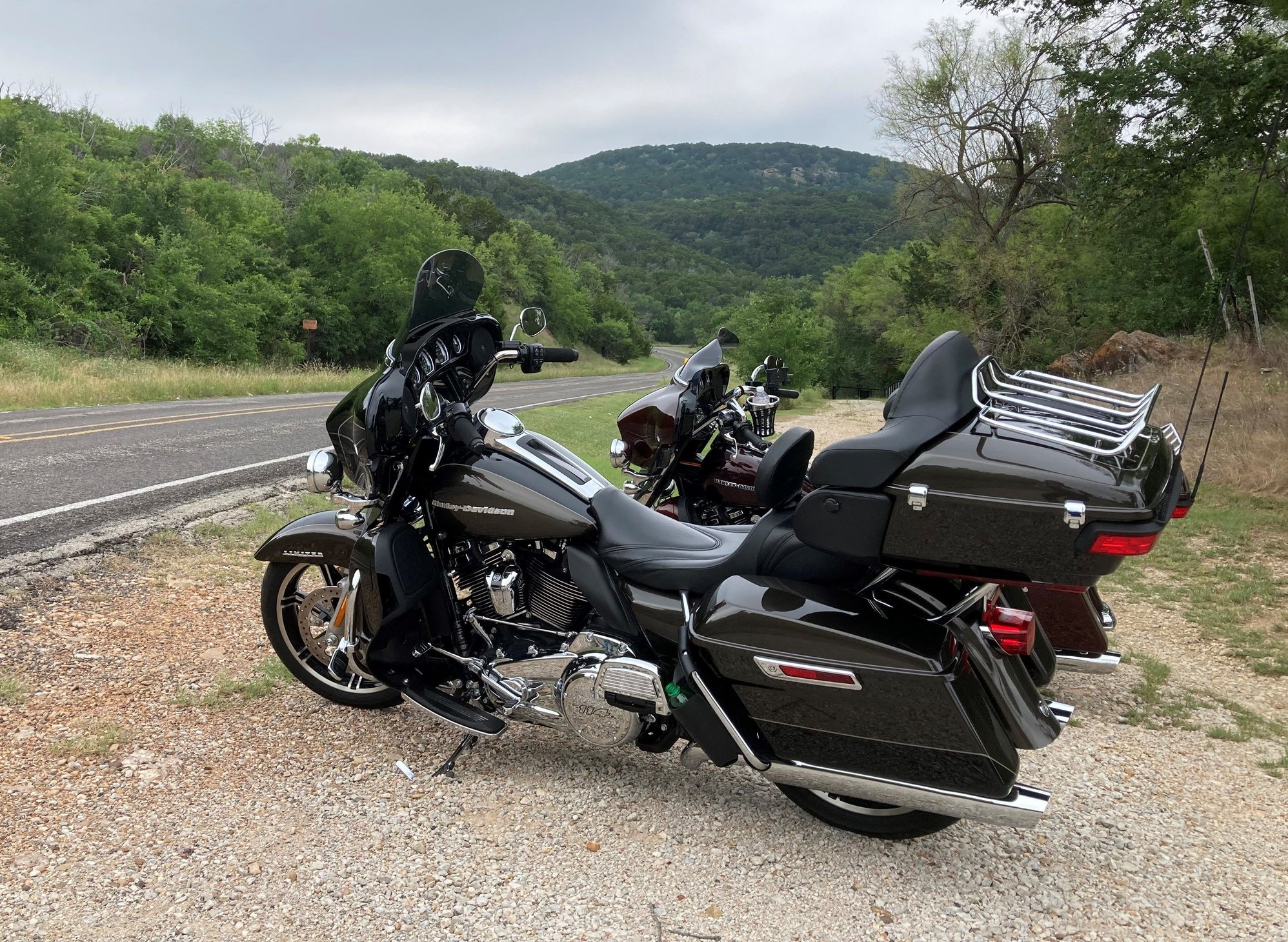

I'm 6'3" with a 35" inseam...and agree with pretty much everything here.
Footboard relocation is a key for sure. I had the Tallboys kit on my previous 2012 UC and really liked them...a-lot! So I ordered up a set for my 2020 RGL but they're still sitting on the shelf.
I did trim the lowers on my previous bike but am a little reluctant to on this one. Getting the footboards out & forward is important for my comfort.
Currently I'm using the Kury spacers (1" out & 1" forward) plus the HD Extended footboards (1" forward). So now I'm 1" out & 2" forward and pretty comfortable so the Tallboys may stay on the shelf.
Got the HD 360 degree adjustable highway peg mounts, Softbrake extended shift levers & +1W brake pedal, and 12" KST Pioneer bars (fully adjustable).
The one point we differ on is the seat. For "me" (and probably not you), I don't mind sitting a bit higher. In fact, I find it helps to extend the legs a bit more and puts my knees & hips in a better place.
I've dealt with lower back issues and find If I can keep my knees & hips as level as possible, it's way more comfortable...for me. I can't have my butt/hips lower than my knees.
For that reason, I'm running an HD Hammock. It's the early version (52000003A) that actually moves me back just over an inch and sits up a bit higher than stock.
Unfortunately they don't make this seat anymore but can be found used. I believe HD says it fits up to 2013 but I kept it from my 2012 and fits my 2020 just fine.
And yes...a back rest is also crucial for me. I use the fully adjustable HD issue one.
Regarding the "higher center-of-gravity" issue, something I've always wondered about is all the police/law enforcement officers out there using the police seat.
This sits them up considerably higher and doesn't seem to hinder them in handling their bikes. They can throw those bikes around way better than most.
Anyway, here's my footboard setup with the Softbrake +1W brake pedal...
