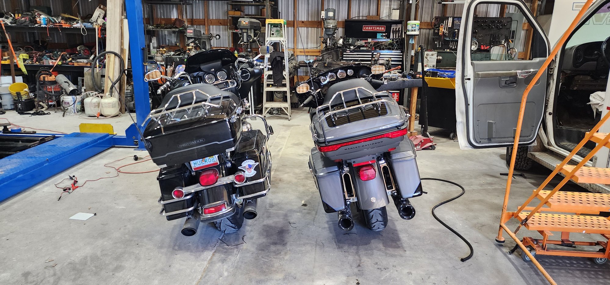

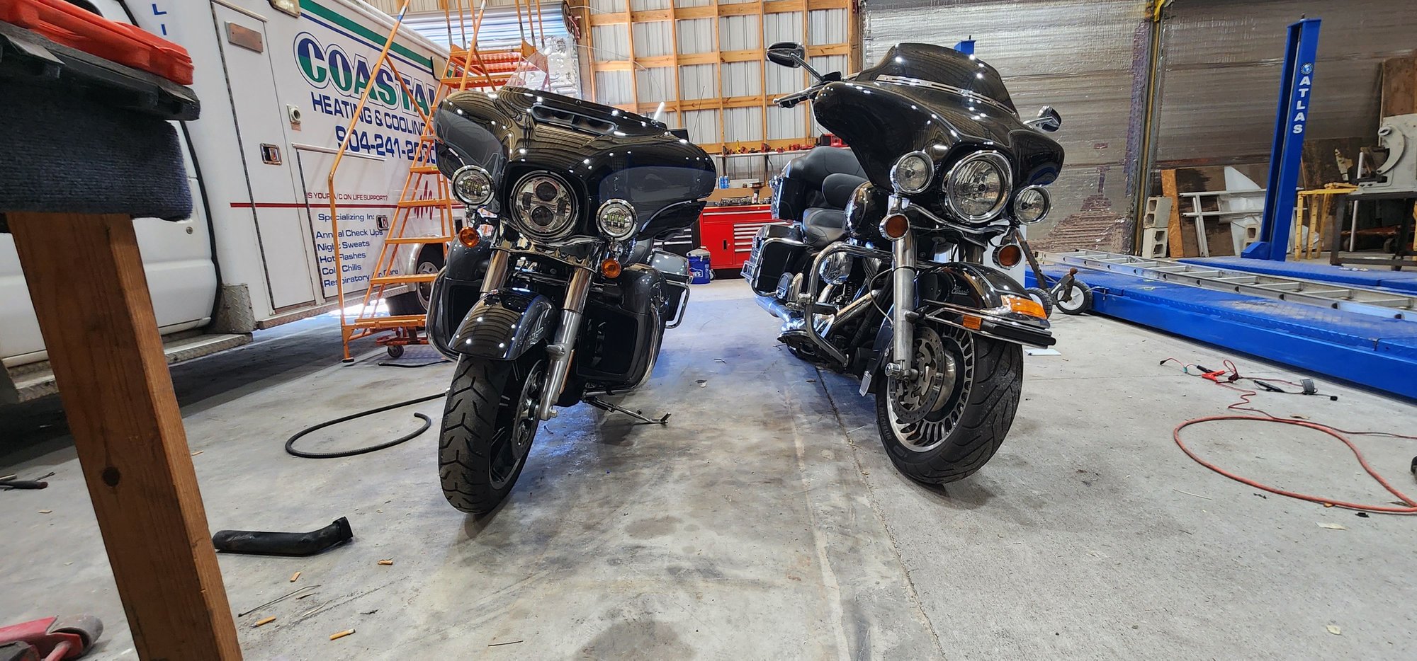

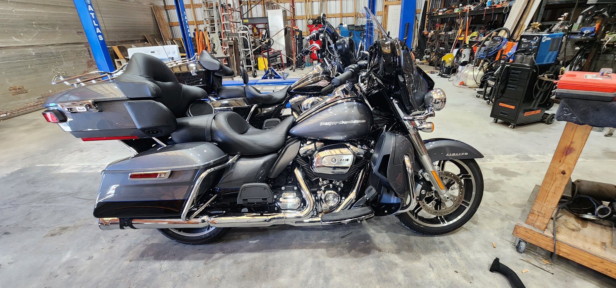

Here's a couple side by side shots of my 2 girls.

what did you have done with the 13? its pretty much the same stuff. pretty much everything on those 2 bikes is interchangeable as far as what will get you into a riding position, and alot of other stuff is the same. if you liked the 13 you know your formula for comfort already.
