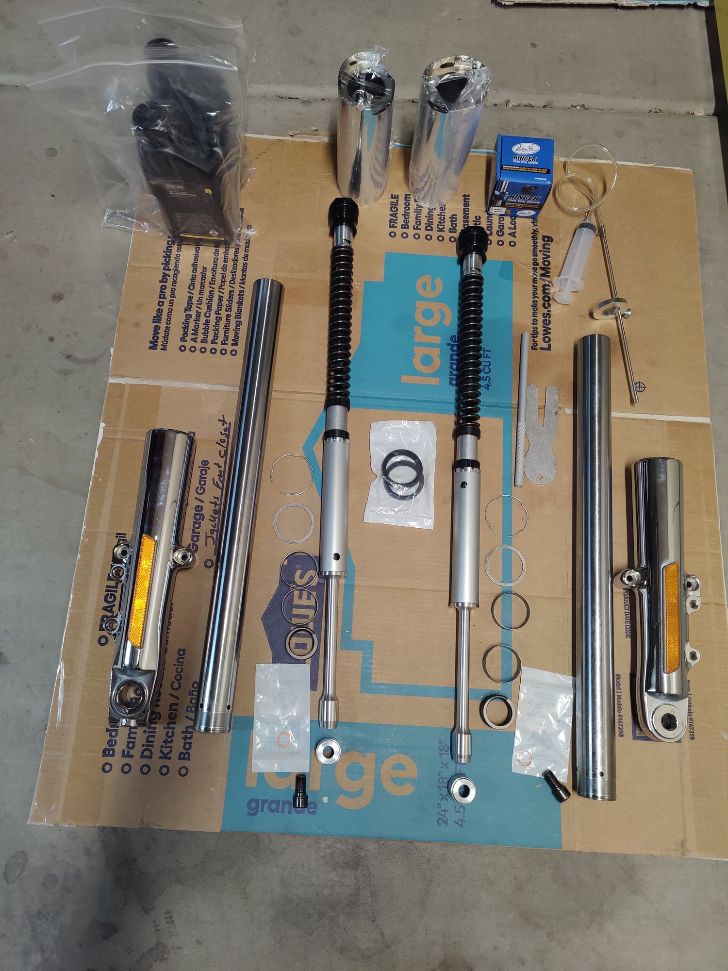

Got all the parts for my fork build. Hopefully they live up to the hype. Went plus 2 going on my 2022 RGS
32mm big bear Ohlins

Running the HD branded Ohlins 044 in 13 inch.

I have 13s and +2 right now because thats what the PO did. It sits a little nose-high, and turns in a little slower. I'm adding a 1" lift block to the rear to get it even again. You might want to think about doing the same - the higher front throws off the nimbleness a bit.
I need to check to see if the axle nut will clear the muffler with the extension. But ya I would like to raise it up on the rear
