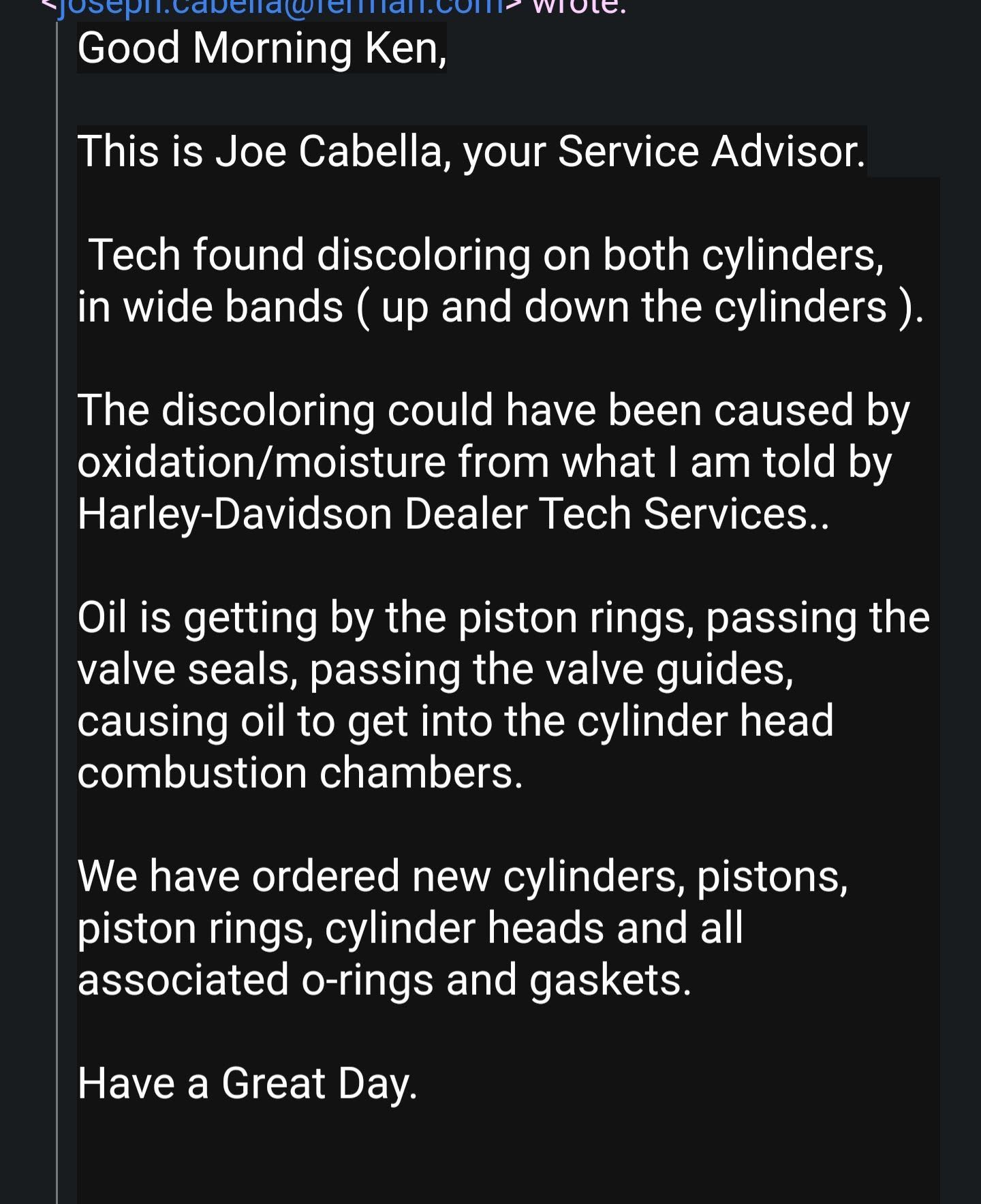

Here is what Harley told me...

5 year extended warranty... this rebuild is gonna cost me just the $50 deductible
No wonder why the techs are like, "Nope, can reproduce the problem" They probally knew the issue was there and didn't want to deal with it. Glad you stuck with your instincts.

LOL'ing at H-D dealer tech services for saying the discoloration could have been caused by moisture/oxidation
It was caused by an engine that got real hot
Yep! I laughed at that too when I read it. Moisture….the only moisture available is from condensation which boils off pretty quickly once warm enough. Crazy.
Its a joke considering my bike is kept in a garage in Florida, its got its own natural heating system lol
