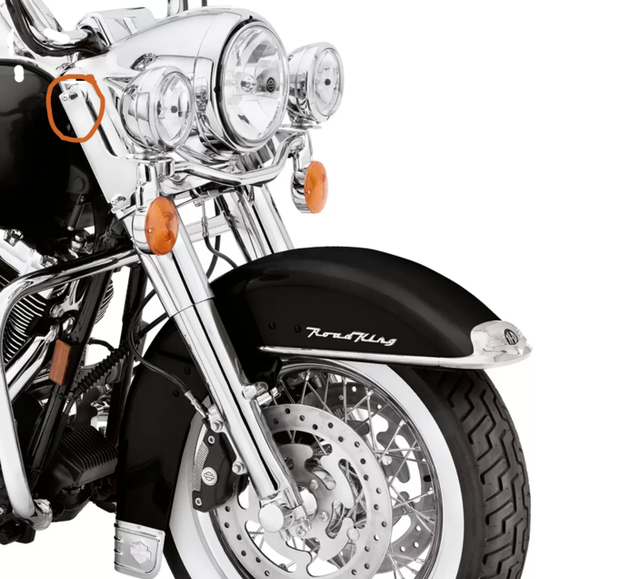

Trying to figure out what thread size this nut is on a 2001 Road King? I can't find it on any parts diagrams. Not my bike in photo, just a photo that i used to circle the acorn nut.

Umm Mine had a bolt there not a nut.

Here is mine, looks like acorn nuts. 2 on each side

It's 5/16-18.
ETA: 7886
ACORN NUT 5/16 X 11/16 X1/2
