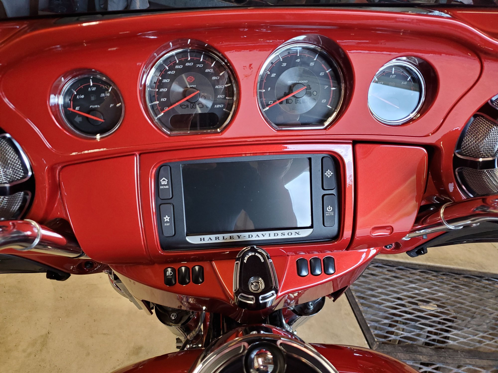

I need to replace the lenses on my speedo and tachometer gauges. I looked around and couldn’t find a direct replacement or an easy swap out for these. Does anyone know if that is possible? Bike is a 2019 Ultra Limited.

I just wish the lens could be removed for cleaning inside/behind. I have seen moisture more then once turn into a droplet run and mess of the inside of the lens.
There are videos on how to remove the lens from HD gauges ... Not an easy task
