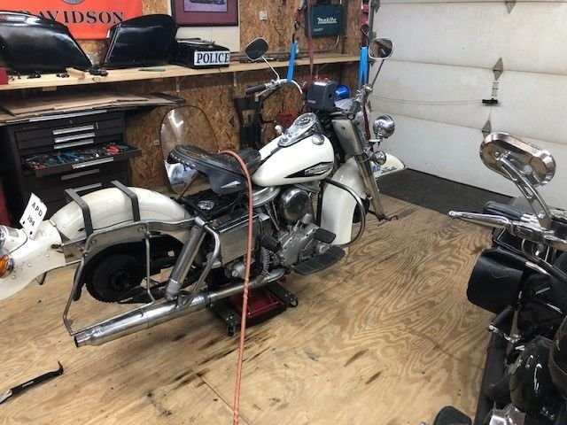

Originally Posted by FlamedFXR
Call for a tow. Unless you carry a jack, tire
Sure was easier ( lift height ) when we had hinged rear fenders !
