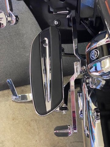

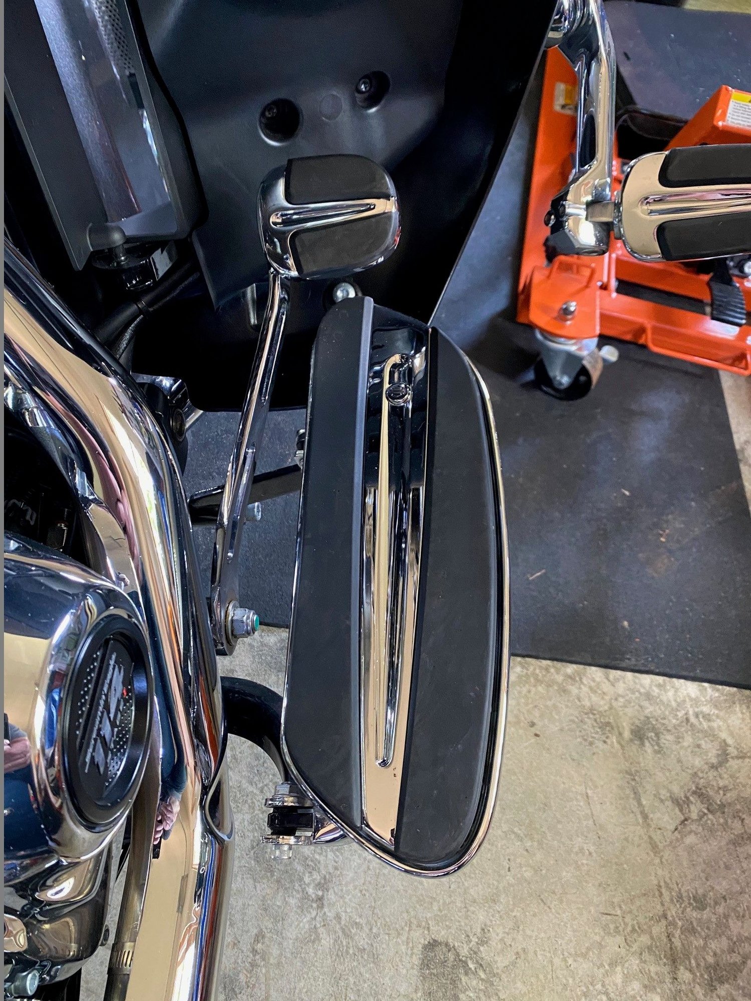

Several years ago I bought a set of the extended reach footboard pans from H-D. Mine are the Swept Wing style and I topped them with Slipstream inserts or pads. I liked them so well I used them on our new custom build in '20. I combined them with Softbrake outboard extensions to move them laterally 3/4". I'm so comfortable with them I can't imagine going back to the stock position.
The extended reach boards will NOT affect guys with shorter legs. It's not like your knees and legs are suddenly straight by using them. the benefit is in improved knee / ankle angles, and to a lesser extent hip angles possibly. That was my rationale for using them. My knees were uncomfortably bent and I wanted to give them a bit more extension.
I equipped the passenger with chrome mounts, chrome swept-wing pans and Slipstream tops to match mine overall.

@StoneTrekker How do you like your extended heal shifter? I hate the stock heal shifter because it’s too short and takes up too much of the floorboard. I installed an extended one like yours. Soooo much better. I can actually use the whole floorboard now. Along with the floorboard spacers, it makes for a much better ride.
Old Feb 28, 2023 | 07:59 AM
StoneTrekker's Avatar
StoneTrekker
Joined: Jul 2017
Posts: 2,326
Likes: 2,402
From: Jackson, OH
I like the extended heel shifter. I've got it set so all I have to do is elevate my boot heel slightly and drift it back over the heel peg...rock my boot and that's it. No more being on the ball of my foot and having my heel up in the air to get on the heel shifter. Plus I have 100% of the board available for my boot. Win-Win for me.
