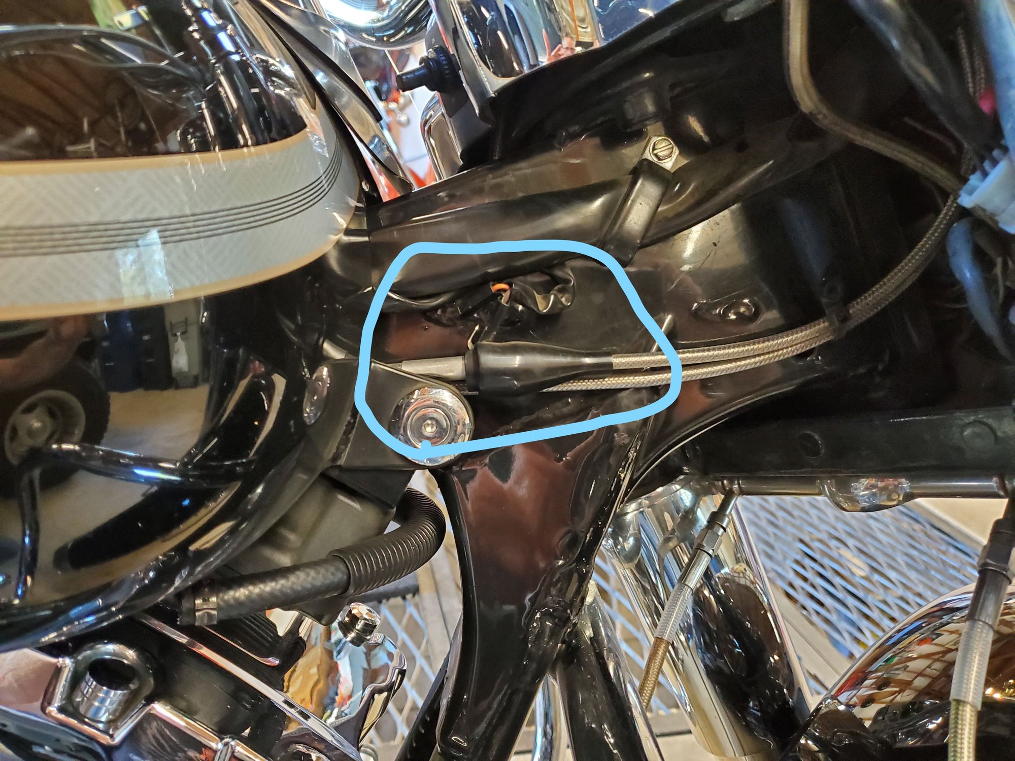

Mine quit when I installed apes. I could not figure it out. All the tests seemed ok. I bought the electrical trouble shooting manual. Used that flow chart found my problem in just a few minutes. It was a bad connection in the headlight.
