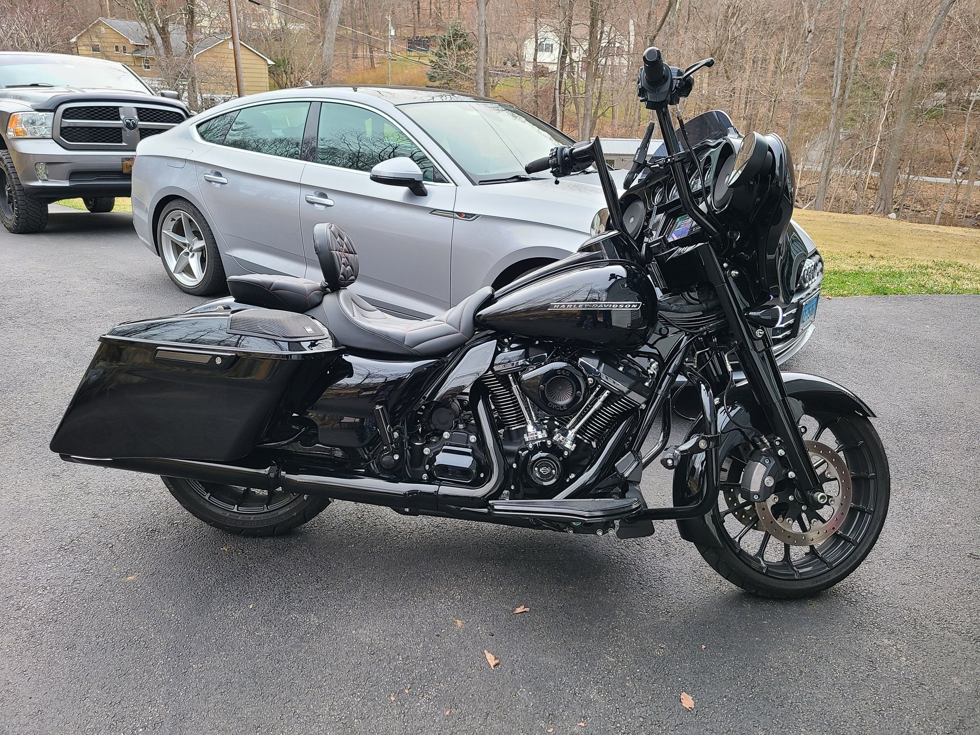

I had my son in laws heat shields and slip-ons high gloss powder coat with a high heat powder coat. I believe it was 600 to 800 Degrees and it's been flawless for 2 years. It was high gloss black. The powder coating shop didn't have it on hand and special ordered it. The can was 80 bucks extra. I also found the below link online and it's high gloss black in high temp
https://www.powderbuythepound.com/hi...ler-black.html
I remember seeing that bike before. Those came out really nice!
The powder in your link says it has some wrinkling to it. I believe it would come out same as factory. I want the finish to be smooth and glossy like it shows in your picture.
This is who I used. Give them a call and ask for Jose. Ask him about the high temp powder coat he used on the heat shields he did for Ron...I'm sure he will help you.
