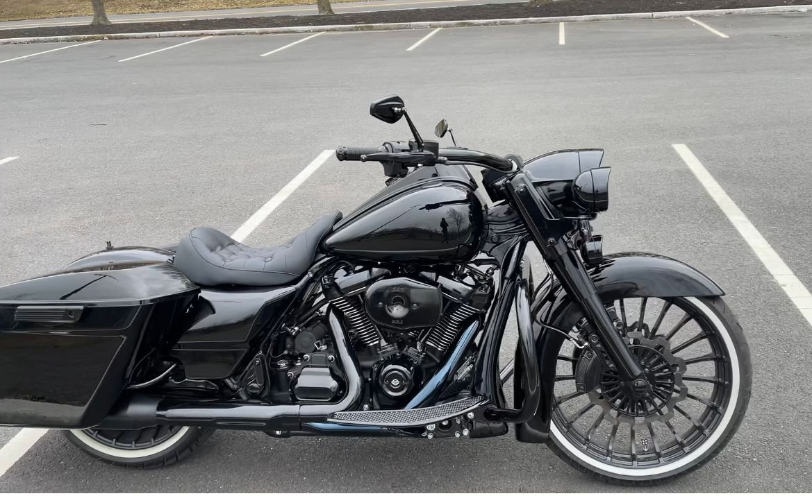

So I had my M8 heat shields powder coated gloss black two years ago. My experience is that the gloss black has held up pretty well. I had no fading or discoloration until I did big bore kit (produces much more heat) and it only faded on the heat shield connected to the front cylinder. The other heat shields are still in good condition. So just recently I took the front cylinder heat shield back to powder coat, which cost me $50. Here is a pic so you can see the fading after two seasons and 5k. I say got for it.

I remember seeing your bike because it is hard to forget it. What a beautiful ride. I really like how the high gloss shields look. I don't have any big bore kits or anything like that. I was even thinking maybe wrapping the headers in heat tape to help shields a little?
From sounds of it, I should be good to go!

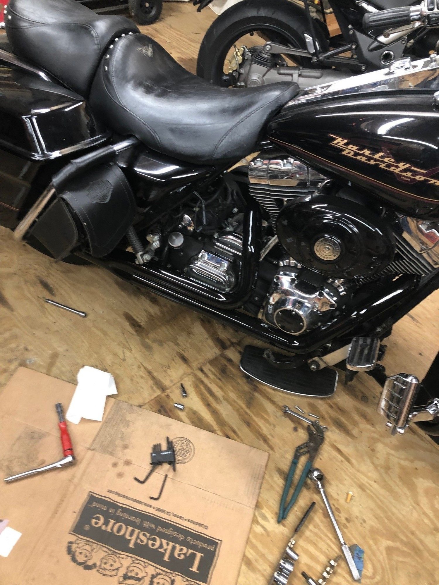

Here`s the cheap version
You live in OHIO , not like you couldn`t touch it up over winter if required
beautiful!!!!!!!!!!!!!!!!!!
Is that painted?

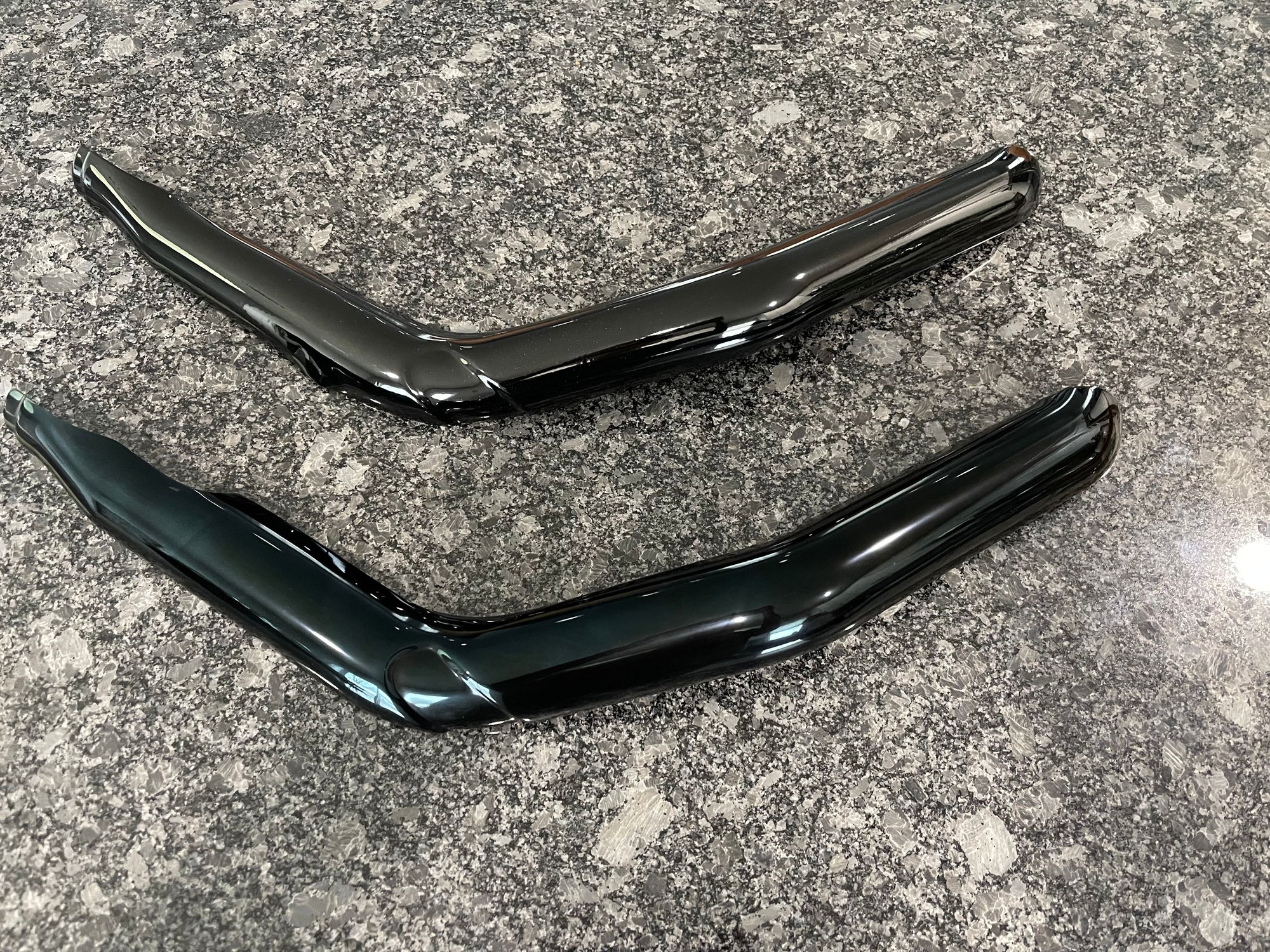

Here is something further to consider. The top heat shield is the one that I just got back from powder coat. The lower one is the Harley CVO Black Onyx heat shield (p/n: 65400435A, $228.19). I got the CVO one from Harley online bc I figured the finish might last longer than the ones that were 3rd party powder coated.
Def got price gauged but it is what it is. So I installed the CVO heat shield and went for a quick ride. Not even an hour into the ride the CVO heat shield started blueing when it got hot. Disappointed to say the least. Below is a pic. For what its worth I'll be sticking with my powder coated heat shields (even if I have to touch them up ever few years). The CVO one is going up on eBay. Best of luck gents!
