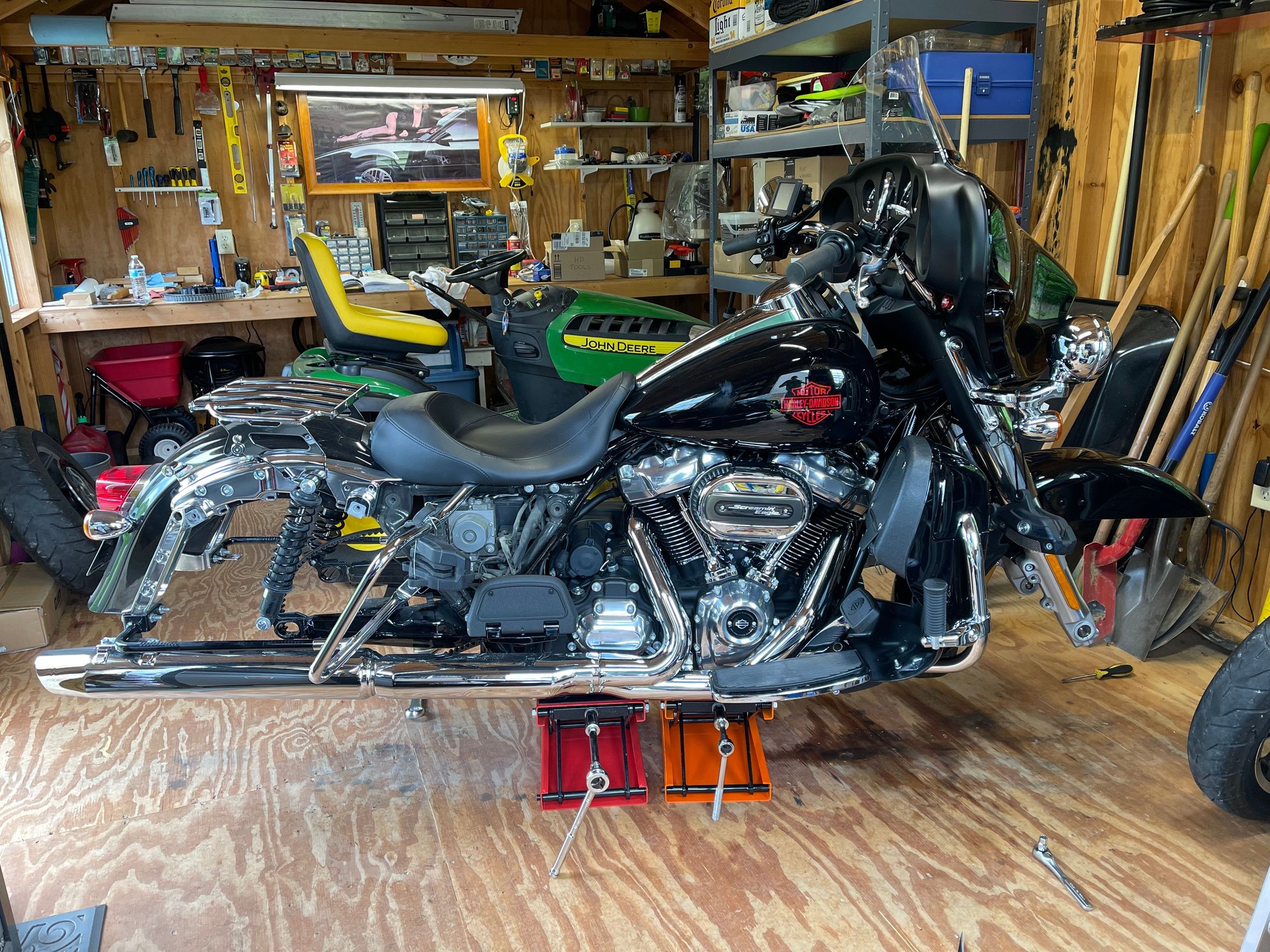

Yuppers. I have V&H powerduels and had to remove both mufflers. I also have HF lift table, but the opening at the back of the deck ain't large enough to drop the friggin wheel through,so you still have to wrestle that pig outta there!
BTW...an alloy wheel, 180/55-18 tire, belt pulley, and brake rotor weight 60 lbs! That's a lot of uffda to wrestle back in place by yourself. Next time I'm going to put bike on lift table and rig up a hoist over a garage rafter to easily sling the whole shebang into place.
That is another mod to my HF lift, I cut a slice out of the rear of the wheel slot so can drop the wheel out easily and made the piece removable.

Anyways, I just wanted to learn how to do this so I tackled it. Really need a lift with drop for the back wheel. It would be so much easier. Or, good bike Jack that brings the bike higher than 1 foot I get from the “let’s roll” type of stand.
s.
I don't t think most the motorcycle jacks get the rear tire a lot over foot from the bottom off the ground , you need to twist the tire out. Maybe 18" You won't pull a tire straight out. What are you using?
If you get a table lift, with drop down rear, you will still need a jack so you can remove tire. But no matter what you wrestle the tire.

I use two scissor jacks and it lets me get the wheels off while staying very stable, also allows fine adjustment at either end when removing or installing the axles.

You typically see one used on a table lift, where you can drop the rear of the table to get more room.

Makes it a lot easier without the pipe on the other side
