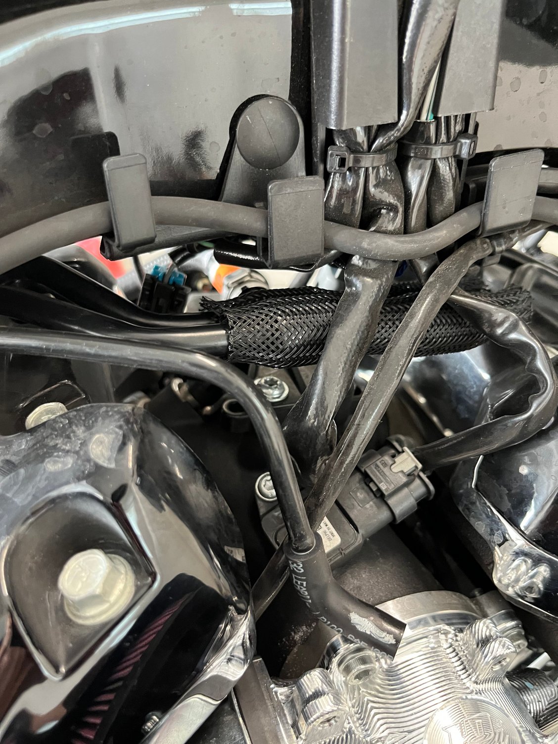

I’m trying to switch out fuel injectors on my 21 road glide special and already removed tank but still a challenge to get fuel rail off. Is there another way to just remove injectors that I’m missing? Do i even need to remove fuel rail? Any help appreciated thanks

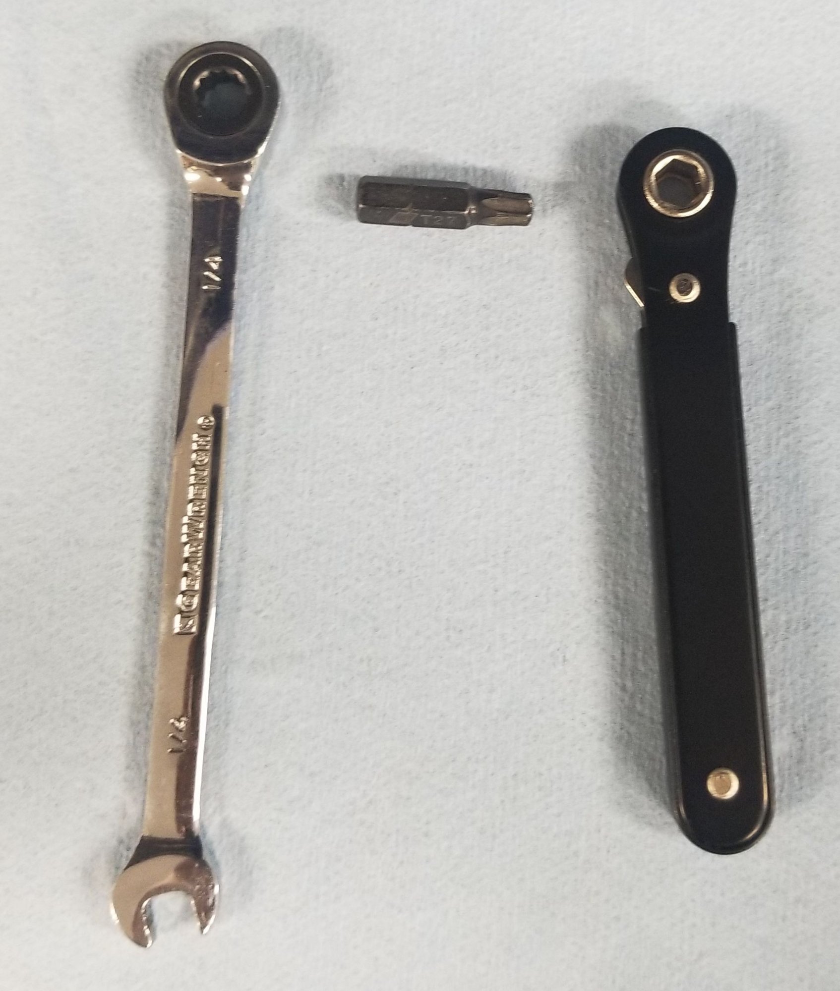

It doesn't look to be easy but, you need to remove those 2 screws holding the fuel manifold on to the intake. Here's an idea. Take the correct size torx bit and use a 1/4 inch gear wrench to turn it. I also have a ratcheting handle for my bit set. It will still be difficult though.
