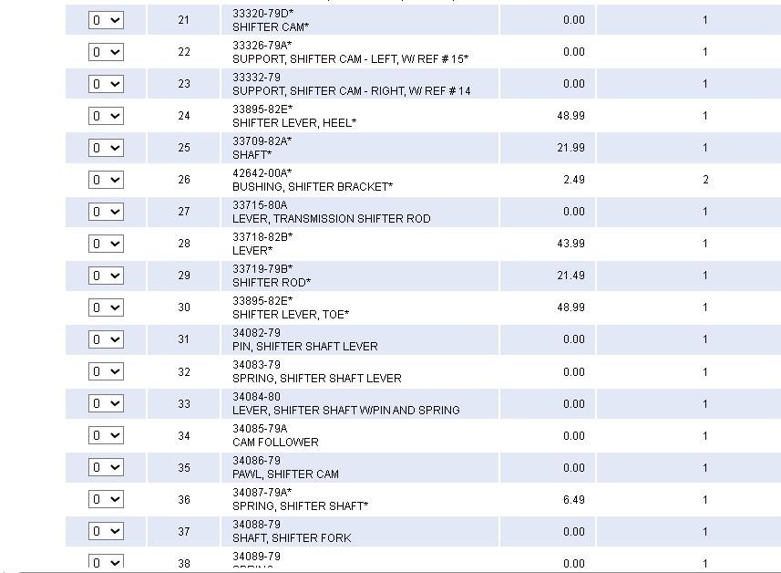

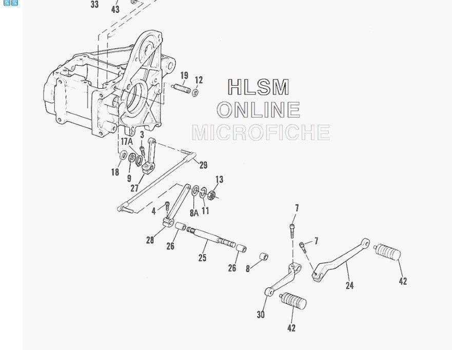

All great conversation, doesn’t help me any. Will the later **** work on my bike? Really don’t want to pull primary apart to replace with the welded piece like is on it. Figured I can tak a cutoff wheel, cut the arm off and replace with the shaft/arm from later.

Went and looked up your bikes shifter, it should be a two-piece unit.
https://partsfinder.onlinemicrofiche...davidsonmc/40#

It would all depend on the sizes and spacing of the two shifter assemblies involved.....
You would have to compare the measurements between the two....
There is no guarantee that the shafts needed are the same length, diameter, and the splines are spaced properly, for the two shifter assemblies to be interchangeable....
The newer system would not only need to fit the older mounting, but it would need to be the right size to allow for proper alignment of the shift shaft to the transmission shift arm. If it fit, but didn't align properly, you could have some binding that would cause shifting issues.
I'm not saying it couldn't work, but that you need to compare the parts and their measurements carefully to decide if it is feasible....
Good luck with your decision and your mod...
NOTE: You may want to spend some time checking things on an online parts finder. On a quick check, the parts list posted by foxtrapper for your year/model bike, uses the same shaft between the forward gear shift levers as a 2005 Electra Glide... That's promising, and worth looking into...
