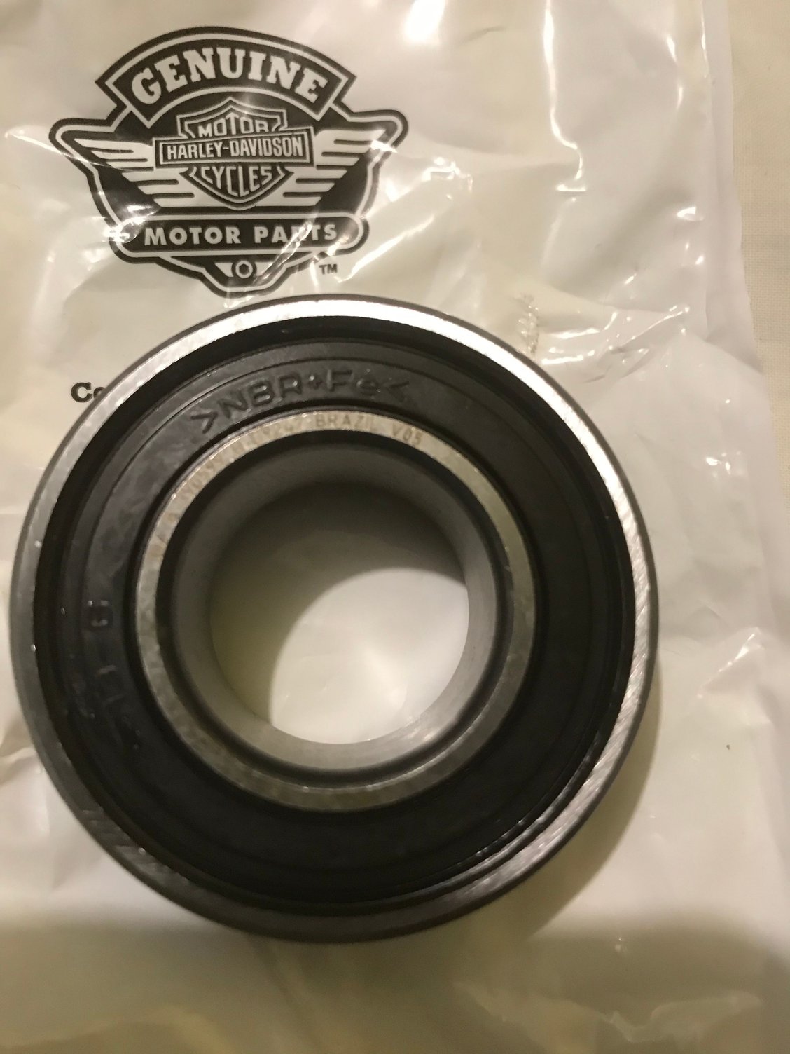

9247 deep grove bearing is made in Brazil

I don't think a 63205-2rs exists even tho you can buy one on amazon. There is ether a 6205 or 3205 ..
The 05 ultra will likely use a special 52mm x 1 inch x 21mm deep groove double sealed ball bearing.. About the only places you can find them is HD, all *****, drag and other distributors. They are likely all made in china.
yep, my fat fingers hit the 3
