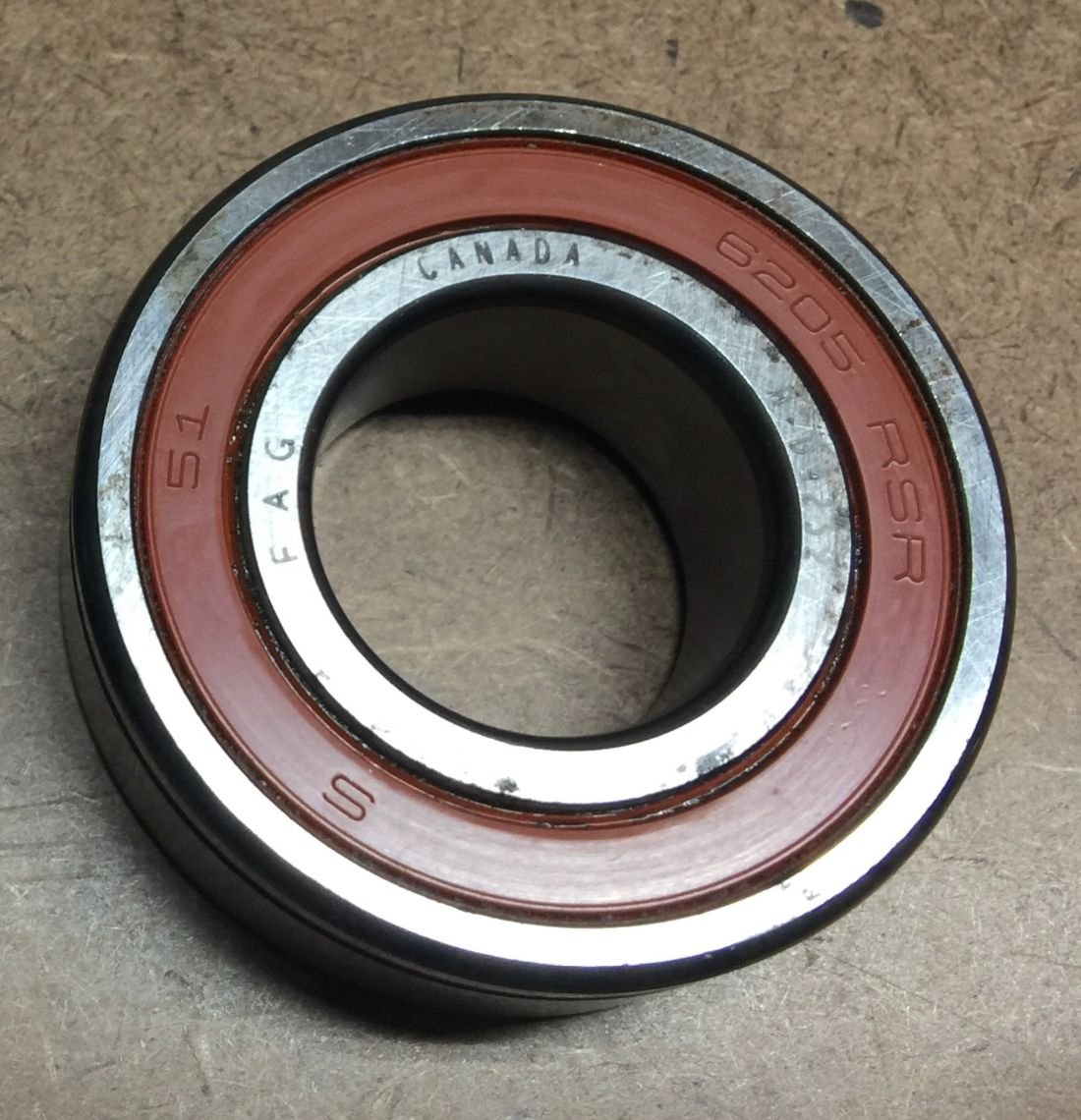

I know for sure the original 9252 encoder side bearings on my ‘14 Limited were *** Canada. That’s all I got.

Was the bearing marked with an identifier?

That leaves little doubt, thanks!

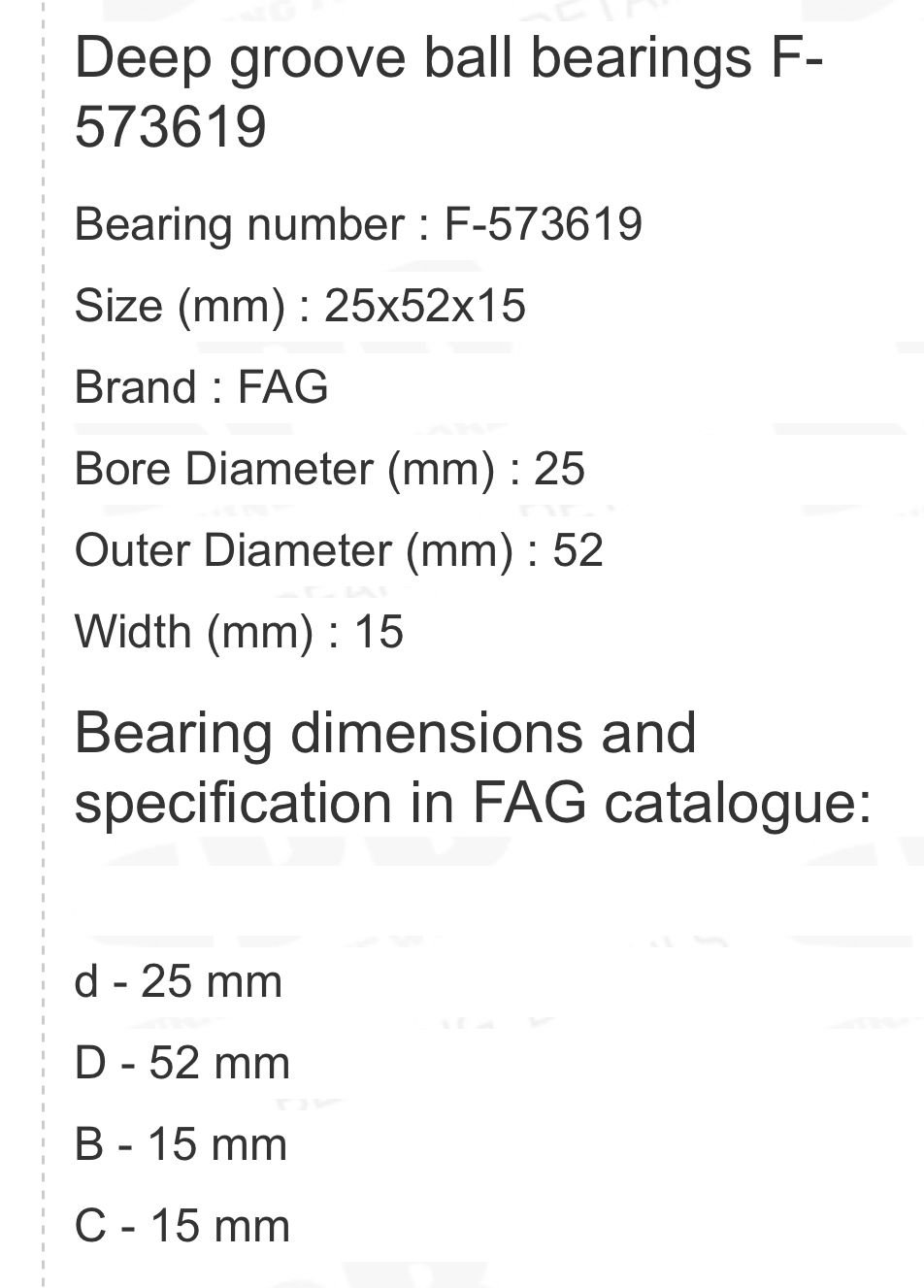

A 9276A bearing I removed has F-573619 on it. I found this doing a Google search:
