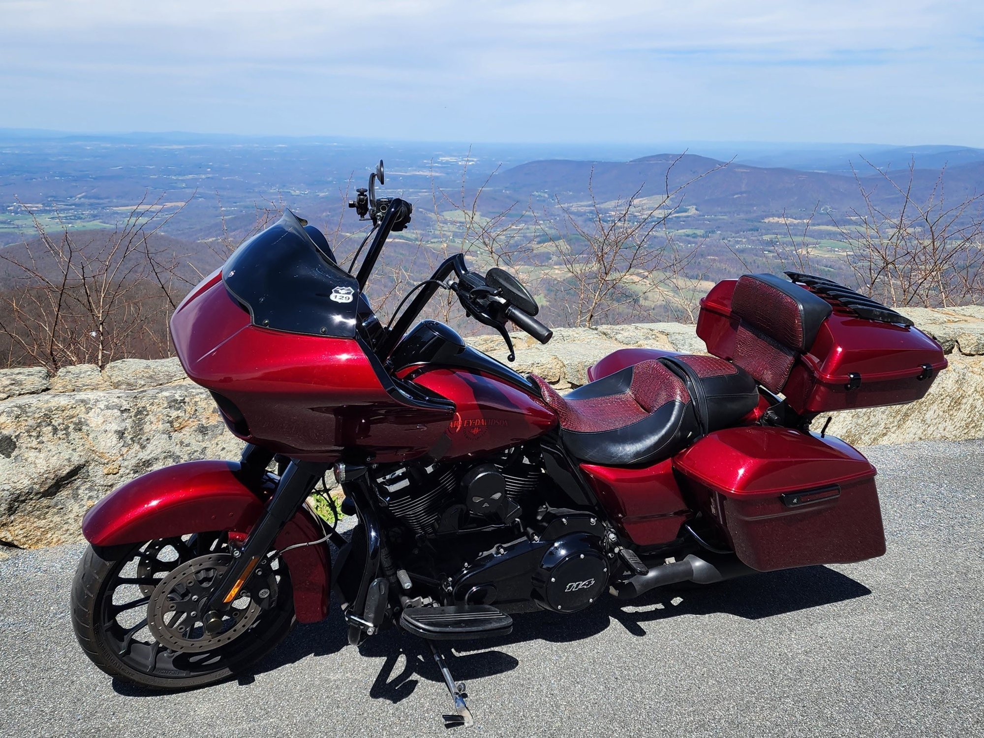

I came from 2007 Road King to my 2019 Road Glide Special and just love it.
I have just ticked over 50,000 miles on it and I was out of the country for two and half years so you can see I like to get the miles down.
I have done 1000+ mile rides in 15 hrs (FL to WV), cruising at 80-85 pretty much all the time. I am only 5 10 but I only have the klockwerks 9in screen, I think you will be fine with a taller screen.
I prefer the RG over the SG as you are less affected by turbulent air from 18 wheelers on the highway due to fairing being frame mounted.
Also I laugh when people say I couldn't get used to the fairing not moving with the handlebars, I say when you ride you 1) lean for curves not turn your bars and 2) you should have your eyes on the road! Plus a RG is much better for slow speed manoeuvres as the weight of the fairing is on the frame not the handlebars.
Just add a trunk and away you go.....
