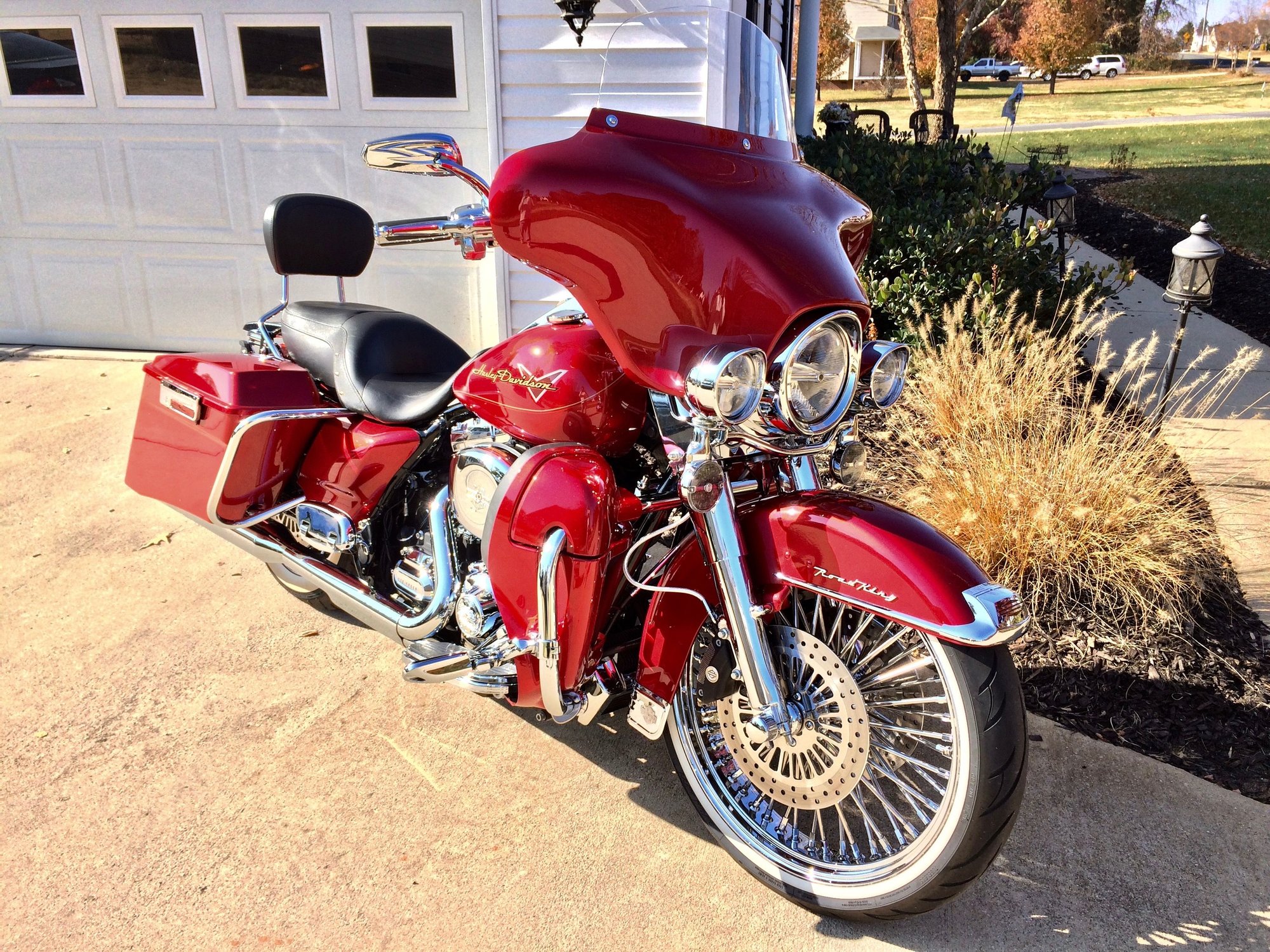

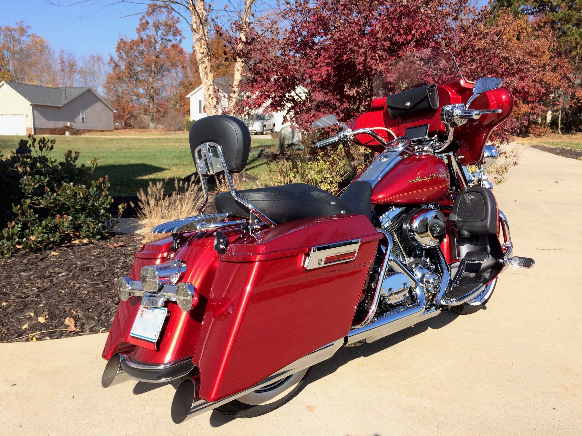

I have this one by Dead Center Cycles. It's the same dimensions as the pre-2014 batwings with easy on and off in a few seconds. I have it with a 12v power port and a lock. They can paint to your CVO color for extra and the nice thing is I can use any H-D fairing accessories like windshield, fairing trim, wind deflectors, etc. I use mine mostly during the colder months and on long trips. Here's my '13 King in winter config.

Lordie, that's as slick as a "mole" I've got an 03 FLHRCI with the detachable windshield. Trying to zero in on the attachment question. Does that rig just slide down in to the existing detachable set up, or otherwise just use the existing bolts that attaches the detachable hardware.
