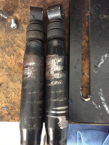

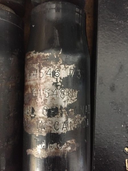

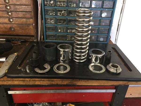

While apart definitely replace the rubber mounts. You need to take the shocks apart in order to see if they are original or repop. 78 FX modes used shocks that were made by Gabriel (Canada)

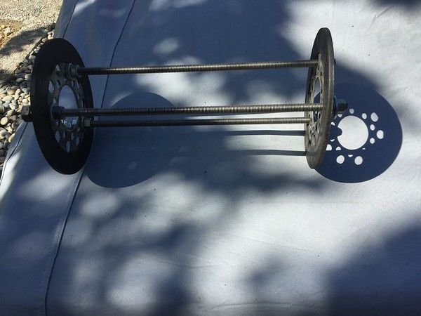

Two old clutch plates, some all thread rod, a couple nuts and washers and you have your tool for taking apart the shocks

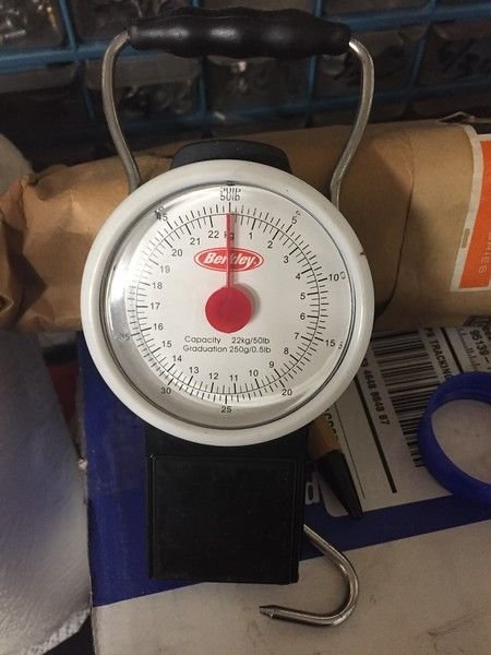

And get something like this to check your preload once the parts are assemble and mounted

Shouldn't move real easy, you want a bit of preload. The older non iso mount swing arms uses a fish scale to set the preload. Rubber ones should be on the stiff side or things can twist under load not being solid to the frame.
