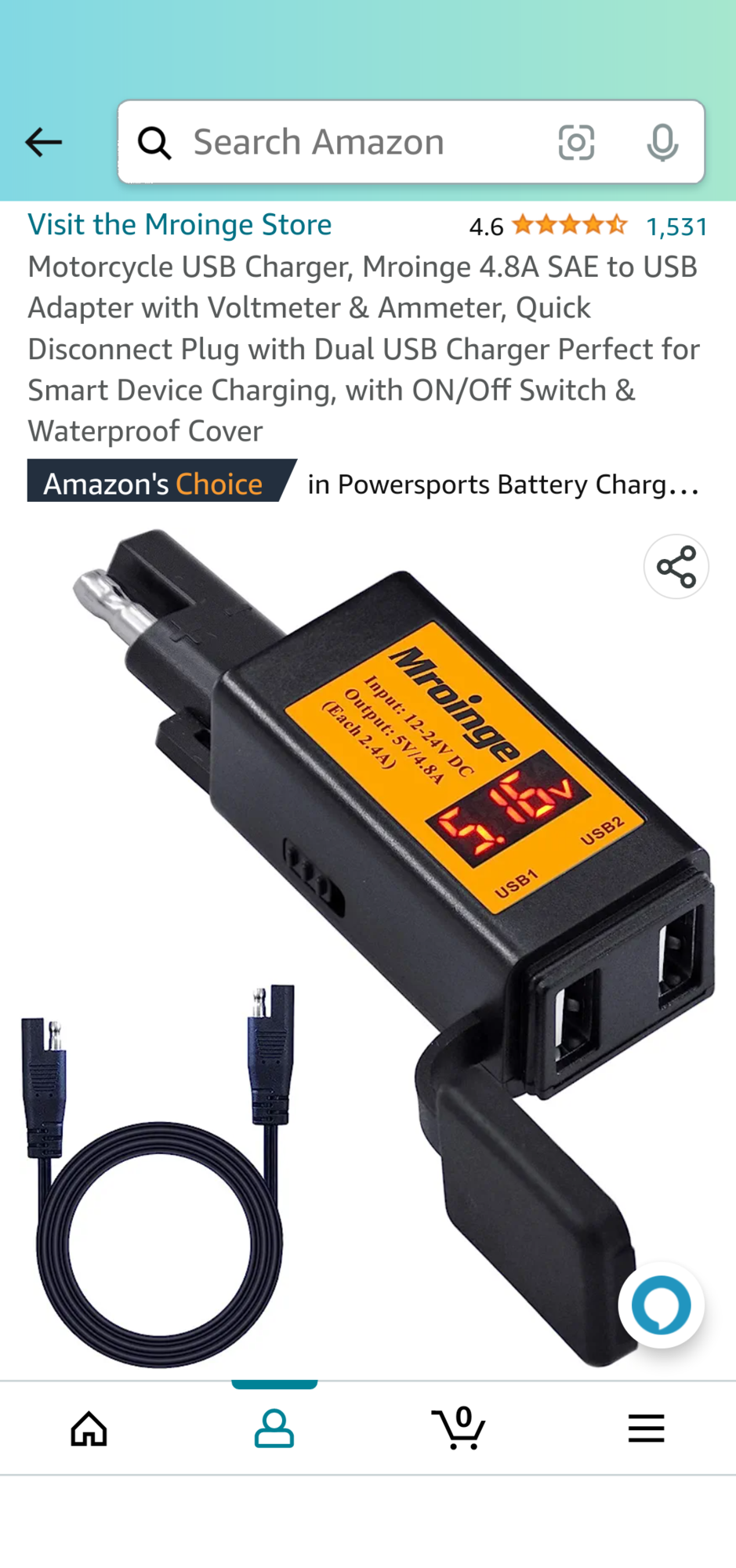

Motorcycle USB Charger, Mroinge 4.8A SAE to USB Adapter with Voltmeter & Ammeter, Quick Disconnect Plug with Dual USB Charger Perfect for Smart Device Charging, with ON/Off Switch & Waterproof Cover https://a.co/d/8508JBH
This is a handy accessory.
It plugs into your battery tender lead so you can charge phones etc. If you get one like this with the voltage readout you can monitor your battery and charging system.
Before you start the bike the voltage should be 12.6-13.5v. after started it should read 13.6-14.5v.

USB chargers when not charging are not drawing anything. I don't leave plugged in bike, cause I have none. but house I do and I have verified with meter they draw nothing.
