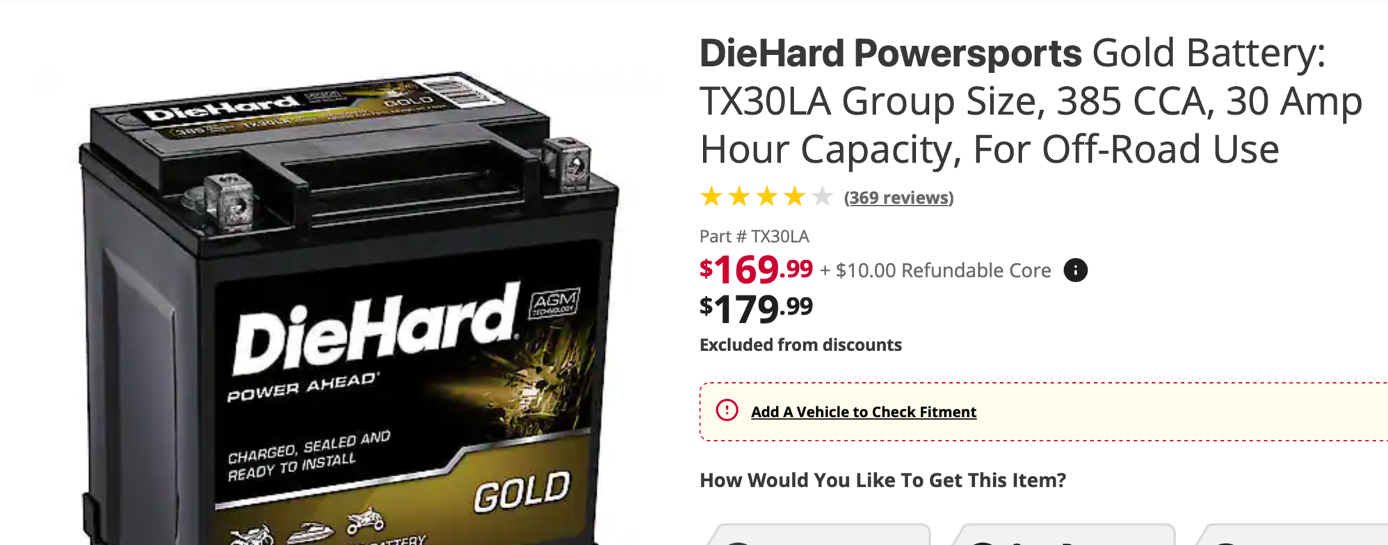

This the battery I got, wished I had read the reviews on the Advance Auto Store website
, so many saying it lasted less than a year, guess I have wasted my money
Gonna see if I can return it.... fingers crossed!
