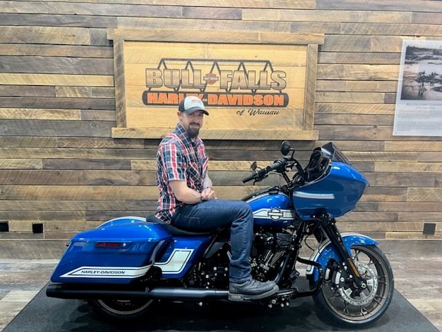

So I'm the one he's talking about. I started with a KW 14" pro touring windshield and that still had the wind hitting my head, I'm about 5' 11"-6'. With just that windshield, one hour into a three hour ride home with a helmet on the buffeting was so bad I had a smashing headache and seeing double vision (I normally don't wear a helmet but was a cold ride home). Also on the ride home after I took the helmet off it was the problem of the wind coming up from the tank so bad hitting me in the chin and whistling in my ears. I did end up trying a 15" KW and it wasn't bad but so tall I really couldn't see over it. So coming home I put on my bad boyz cycles seat(sits me lower and back), put the tripple tree deflector on(the half dish between the forks) and got the GADS, helped a lot but after changing the KW for a 10" Memphis shades it cleared the air well over my head but reintroduced the air from around the tank problem. I tried an 8.5" memphis shades and it's too short again, even with the 10" it's the wind from the center vent that hits me in the eyes and dries them out, but I can't close the vent because it causes more buffeting. I've seen a lot explaining pre rushmore era bikes have less of this problem, and a lot of the fixes suggested can't be done. Like lowers and harleys deflectors, my bike comes with the small engine guard and the fairing mount, I believe, stops me from being able to change them out and lack of the guard I can't put harleys deflectors on. I saw DK customs deflectors and thought about trying them but I i fear those won't work either. A guy I work with warned me that you feel more air on a RG then an SG but I still expected clean air, I knew what fixed it on my SGs, a 6.5" KW and fork fangs and life was good. I hear it all the time people saying how great RGs are compared to SGs and only met two people that feel like I do. Before even making my first payment on this bike and I'm already looking forward to trading it in to go back to a SG.

So if all that wasn't bad enough I had 14" dominator bars on my SG and loved them so naturally thought 14" dominators would be great on my RG and the angles are so weird they don't feel natural. So I'm taking them back and getting 14" factory 47s.
