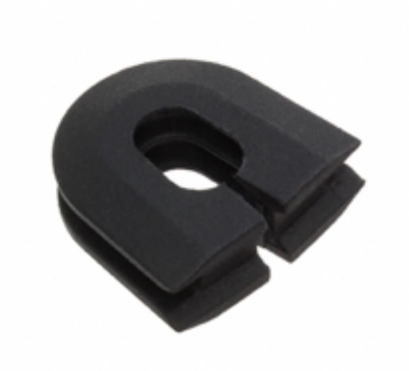

I’m also dealing with speaker wiring going into the bags, and I’m looking at notching the top edge of the bag to allow for a grommet like this:

That could be an option to get the wiring inside the saddlebag. Another option is just a similar but circular grommet.

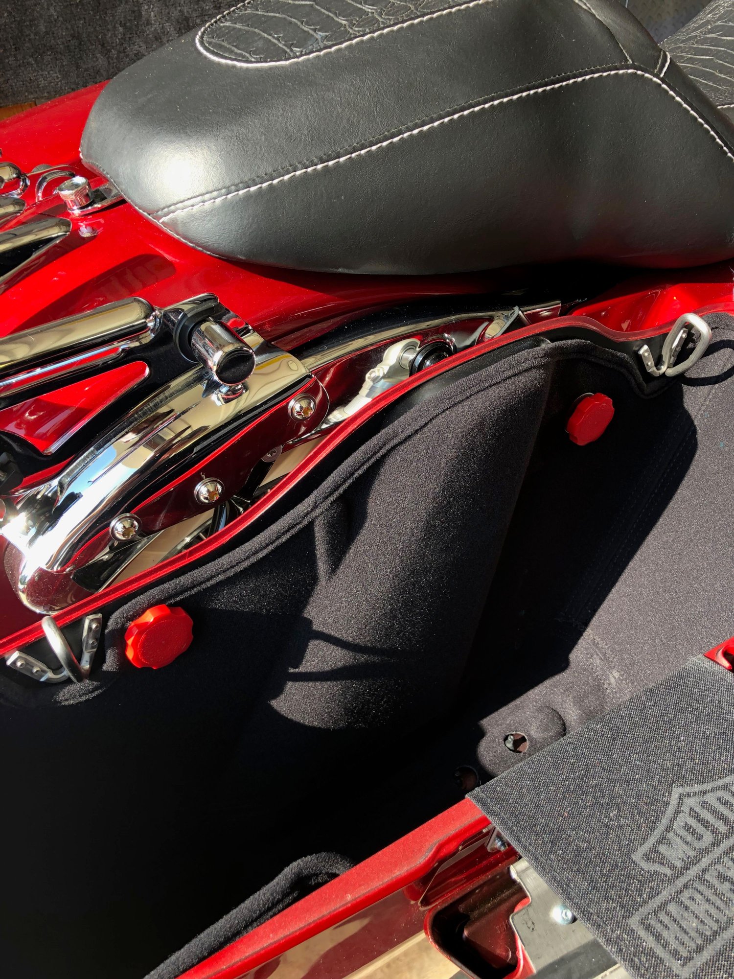

I was thinking of routing the wires in the inside of the bags as well, as I'm not keen to having wires on the outside.
My older style bags had the drop-in liners and I recently upgraded to the new style bags with the liners for my '13 King. I have the red saddlebag mounts pictured below and they keep the liners taught against the bag, so instead of using those CD zip tie holders, I can just tape the wires along the inside of the bags and the liners would hide them.
About a year ago, I saw someone had the low profile saddlebag lights and had drilled a small hole towards the back fender-side of the bag with a small grommet just small enough for the wiring. He ran the wires inside and another small hole towards the front of the bag. It looked pretty clean, but I'm still researching ideas for the cleanest look as well.
