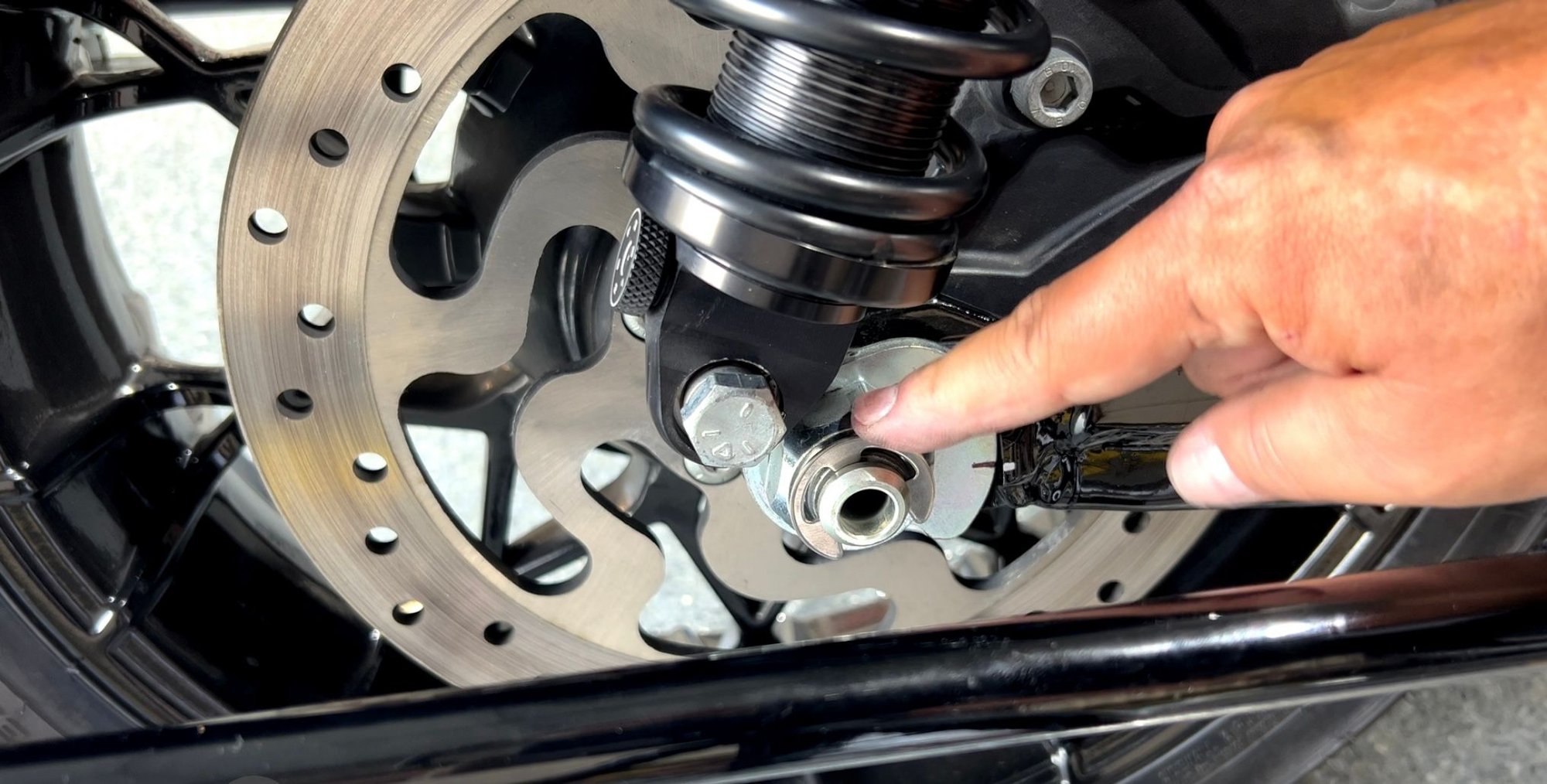

How do you prevent cam plate on the right side of the axle from rotating (right) when you torque the axle nut? Any tips or tricks on this???
Also I know left side cam plate is attached to axle itself but I believe right side cam plate is just sitting freely on right side of the axle. What guarantee do I have that left and right cam plate rotate exactly the same angle at the same time when I am torquing the axle?
Somehow seems like cam plate on the right side is always slightly off. Is there any indentation on right side of the axle to assure cam plate on right side turns exactly like one on the left?

Please share your opinion and especially this trick from first question as it was ridiculous to coordinate this alignment on both sides for some reason as I have to gently tap cam plate with hammer on right side to properly align plates on both sides to be fairly even.
Freaking MoCo doesnt even have marks on these plates which is ridiculous considering how even minor movement can affect the adjustment- what a joke. I marked it with marker for now and nail polish to put dot on my swing arm as some reference

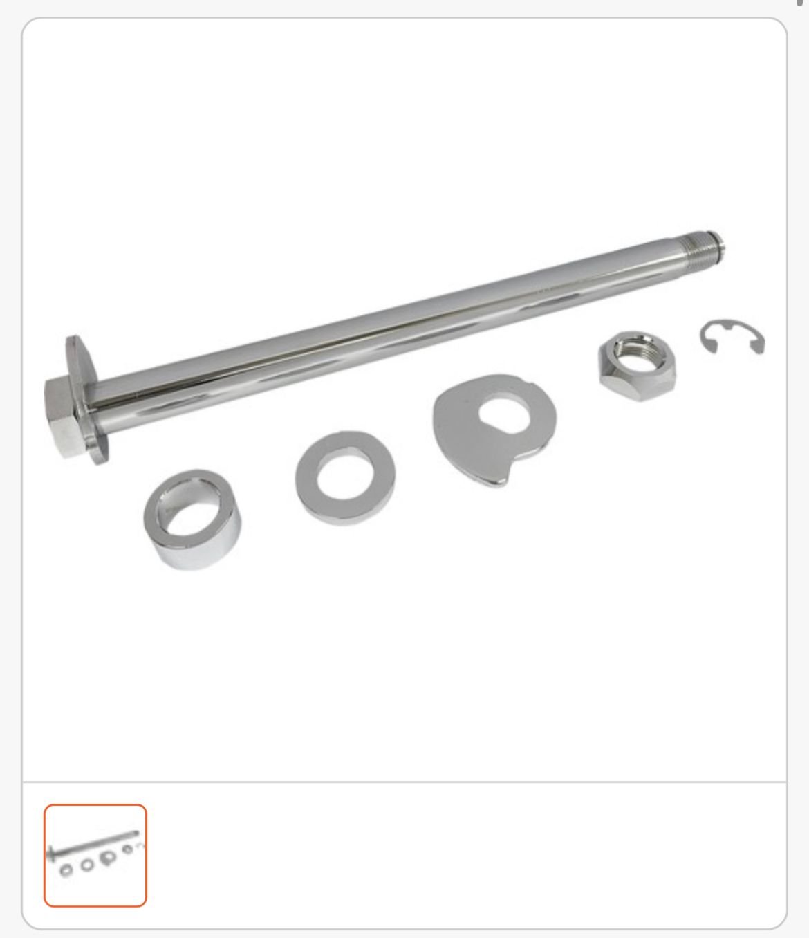

Is there not a flat spot on the right side of the axle where the flat spot on the cam slides on and matches up so as to not let it rotate (coincidentally matching the orientation of the fixed left cam)?
Yes thats the part I dont know as I coudnt remove this cam plate from axle. Do you know if this flat spot is on the axle?

I should check this before seems like you are correct. Looking at replacement parts seems like yes cam plate have flat spot so I assume axle has matching surface which would explain how both sides will move same way on both sides. I guess maybe my mind was playing tricks on me when I measured this.
