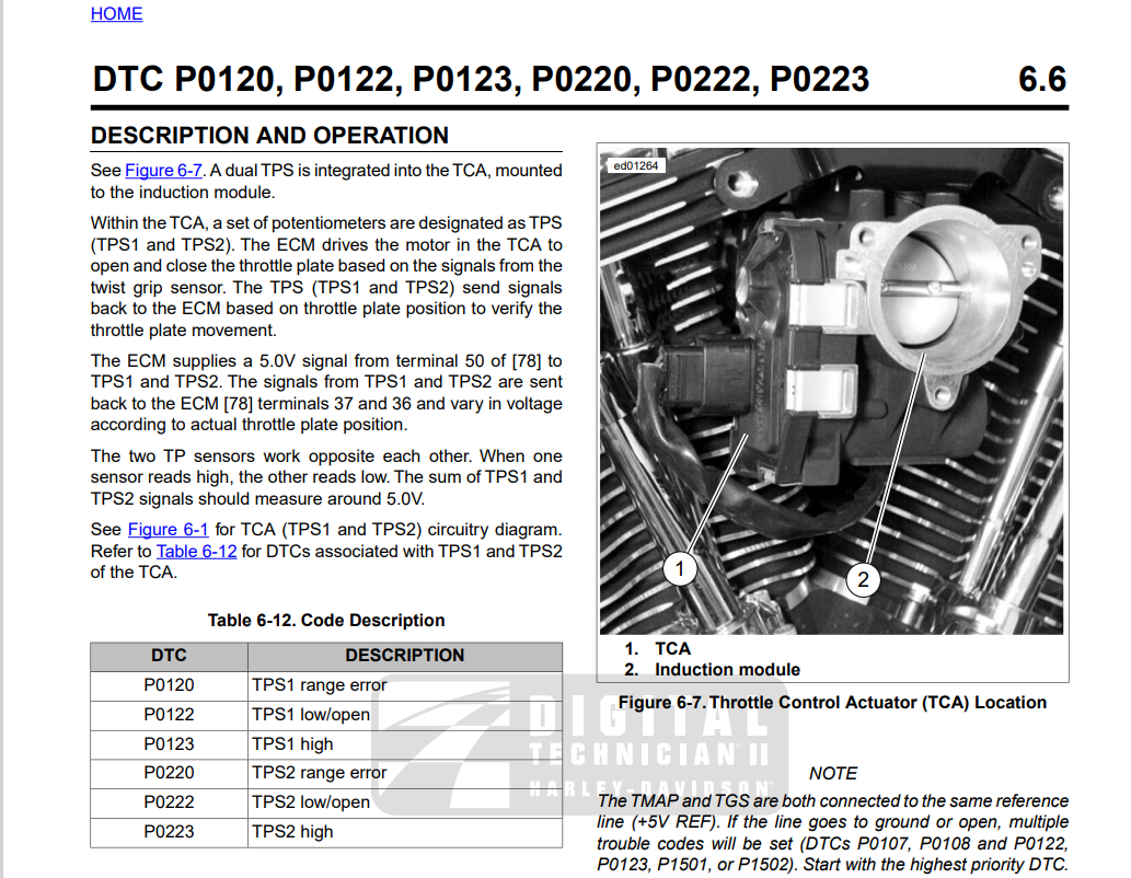

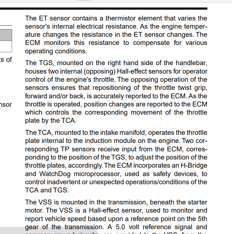

Originally Posted by Vernal
@10FLHTCU
Got to Facebook and join Harley PDF Manual Trade and Share. Click on files and search 2010. Download the Touring Electrical Diagnostic Manual and read about TGS TCA in section 6.
Section 2 has a list of DTC's then shows you which page to go to to trouble shoot the codes. I'm surprised you don't have codes .
wish I had codes.... might make it alot easier to troubleshoot
