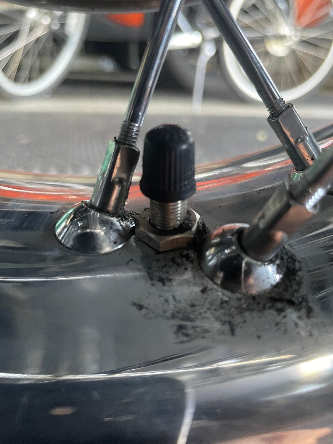

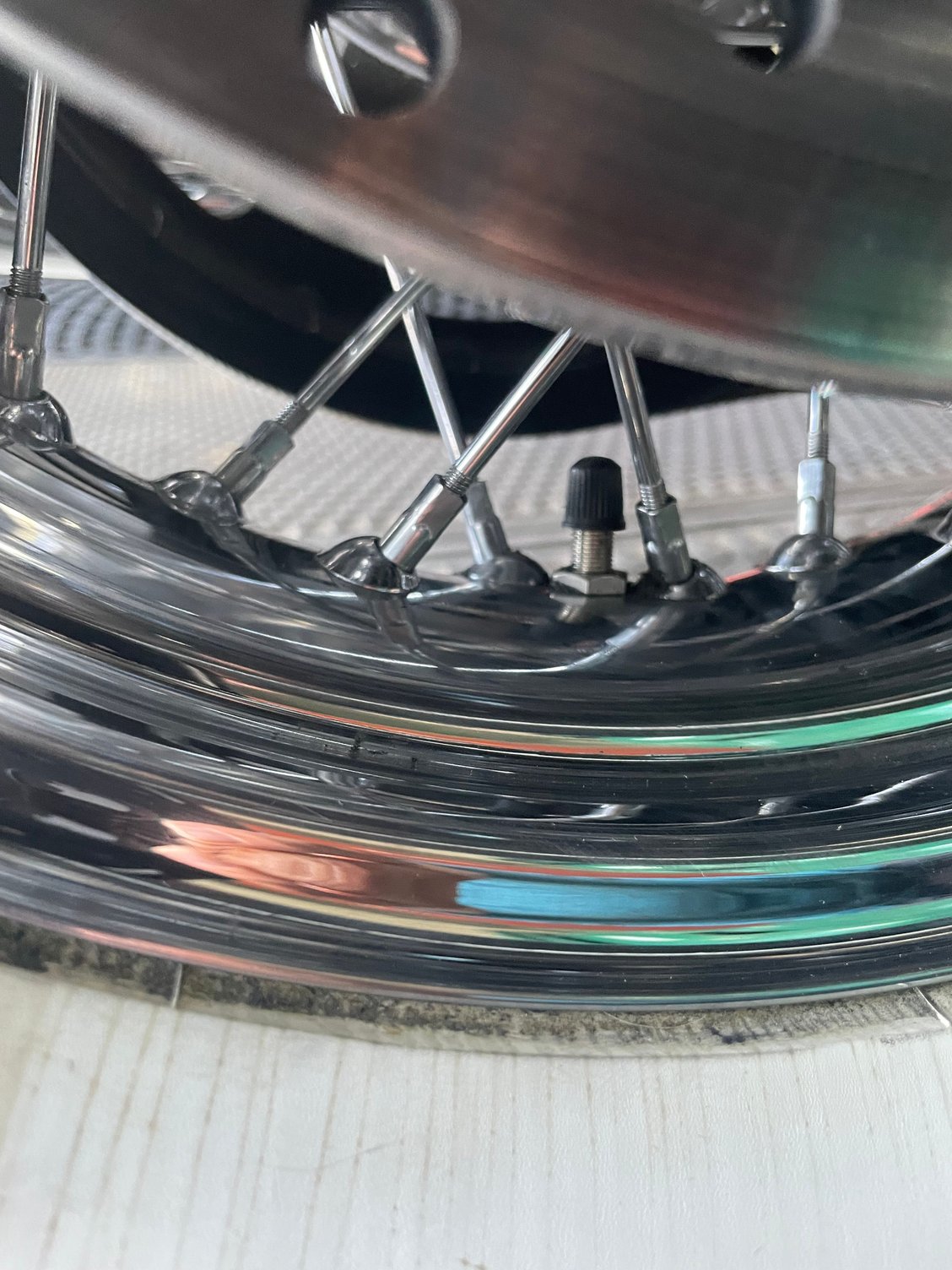

I have tried checking air in rear tire and based on location of valve stem simply can not get tire gauge on (tried 4 different tire gauges). Also can't get air chuck on. Based on the location of the stem, the one spoke and spoke nipple gets in the way. Almost seems like valve stem hole located in wrong spot. Can anyone offer a suggestion? I've had several spoke wheel Harley's over the years and this is the first time I've encountered this problem. Thanks

Old Aug 20, 2023 | 11:10 AM
Hdgone's Avatar
Hdgone
4th Gear
Joined: Aug 2023
Posts: 8
From: Pennsylvania
Old Aug 20, 2023 | 11:23 AM

And that's on the OEM rim?? Hell, how did they even get a wrench on that nut to tighten it on the stem? And this is on a tubed tire too, huh?
Maybe a 90 angled valve stem on a new tube?
https://www.denniskirk.com/michelin/...MaArLBEALw_wcB
I think you can get a spoked wheel sealed for tubeless and maybe go with a Kurvey Girl style valve stem?
https://www.kurveygirl.com/collections/valve-stems

eww. I would think the stem should be positioned about 3 spokes to the left.
I'd be headed straight back to the dealer with that one.

Same situation on the Revival. I'm able to get this pres guage on to check. Working on solution for fill. I've had plenty of 16" spoked wheels on 2014,15 and 16 softails and the valve stem was easy to get to.

Success Gentlemen! Came at from even a different angle with HD flexible extension and screwed it on. Still a bad design. I’m curious if everyone with an Icon model has the same issue.
