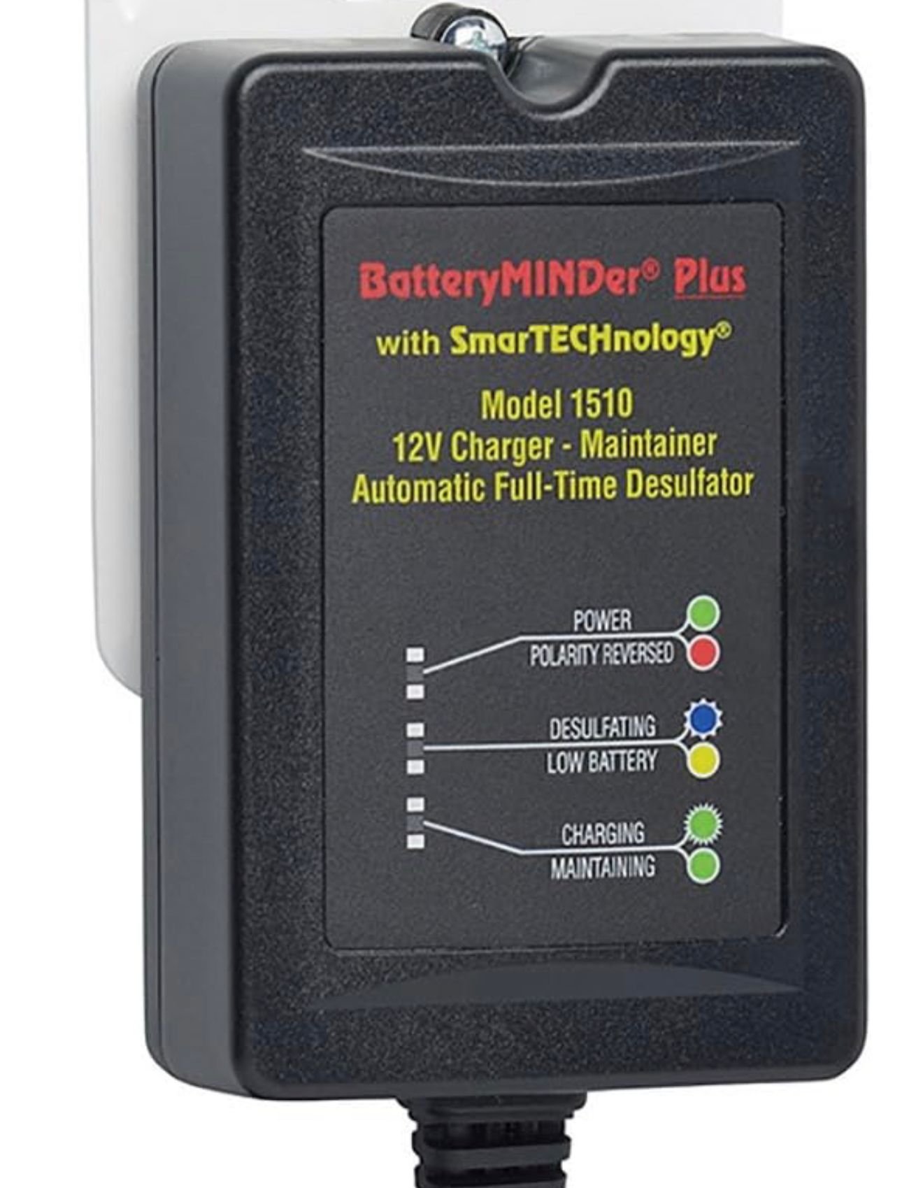

Replaced the original OEM battery on my '09 Nightster at the end of 2016 (7+ years). Replacement battery is a DEKA. At the end of this year that will be another 7 years.
Haven't replaced the OEM battery yet on my '18 Heritage.
Both bikes are always (year-round) on a battery tender (BatteryMINDer® Model 1510).

What’s up with this BatteryMinder ? My friend was saying it’s bees knees. What’s so special about them compared to regular battery tender ?
I put it my Amazon cart but wanted to know why is it special?

Because it has pretty red and yellow lettering.

You can see what BatteryMINDer® has to say about sulfation here...
https://www.batteryminders.com/avoid-battery-sulfation/
More info on BatteryMINDer® here:
https://www.batteryminders.com/7-stage-charging/
https://www.batteryminders.com/faq-1/
Interesting article here...
https://www.motortrend.com/how-to/im...-fact-fiction/
Sulfation is a thing with any lead acid battery and therefore it's prevention would be of interest. How effective the methods (pulses/high frequency techniques) are in going about that are debatable. I my view... Meh... Can't hurt to try one of these approaches. If you can choose between a unit that's offering nothing in this regard and one that offers this feature, why not try the one that has it? Hence, I bought a couple of BatteryMINDers.
One tip I read in an old Wing World article (no longer available) that might be particularly relevant to battery maintainers that don't have a desulfation feature...
A battery supplied with a constant current and held at an unwavering voltage that's less than the gassing voltage will begin to sulfate after 60 days or so. A pulsing current or some method of exercising the battery is desirable during float maintenance.
and ...
​​​​​​​Because the float current neither exercises the battery nor has any pulsation to discourage sulfation, we recommend disconnecting this product from the stored battery for 24 hours every 60 days or so. Reconnecting the unit will then provide battery exercise.
Also... another tip... Battery maintainers should be used all year... Summer/heat is actually worse than the cold.
