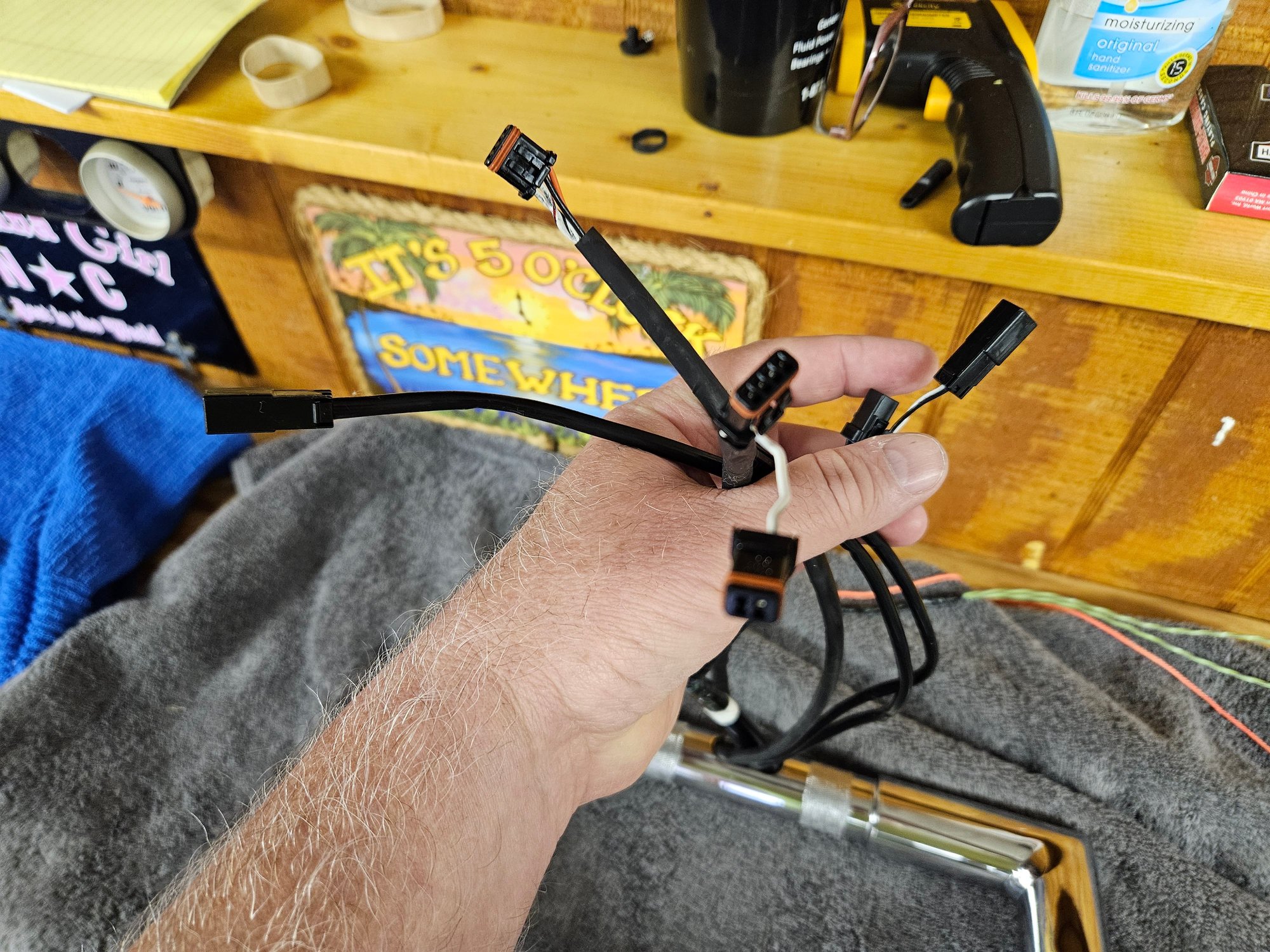

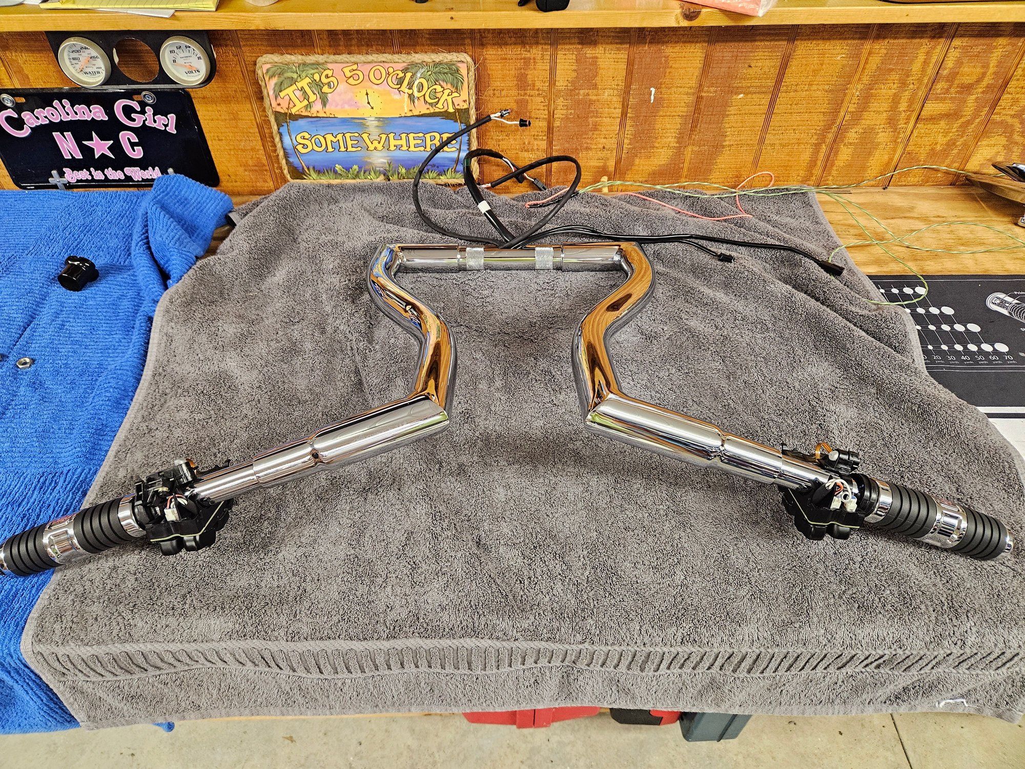

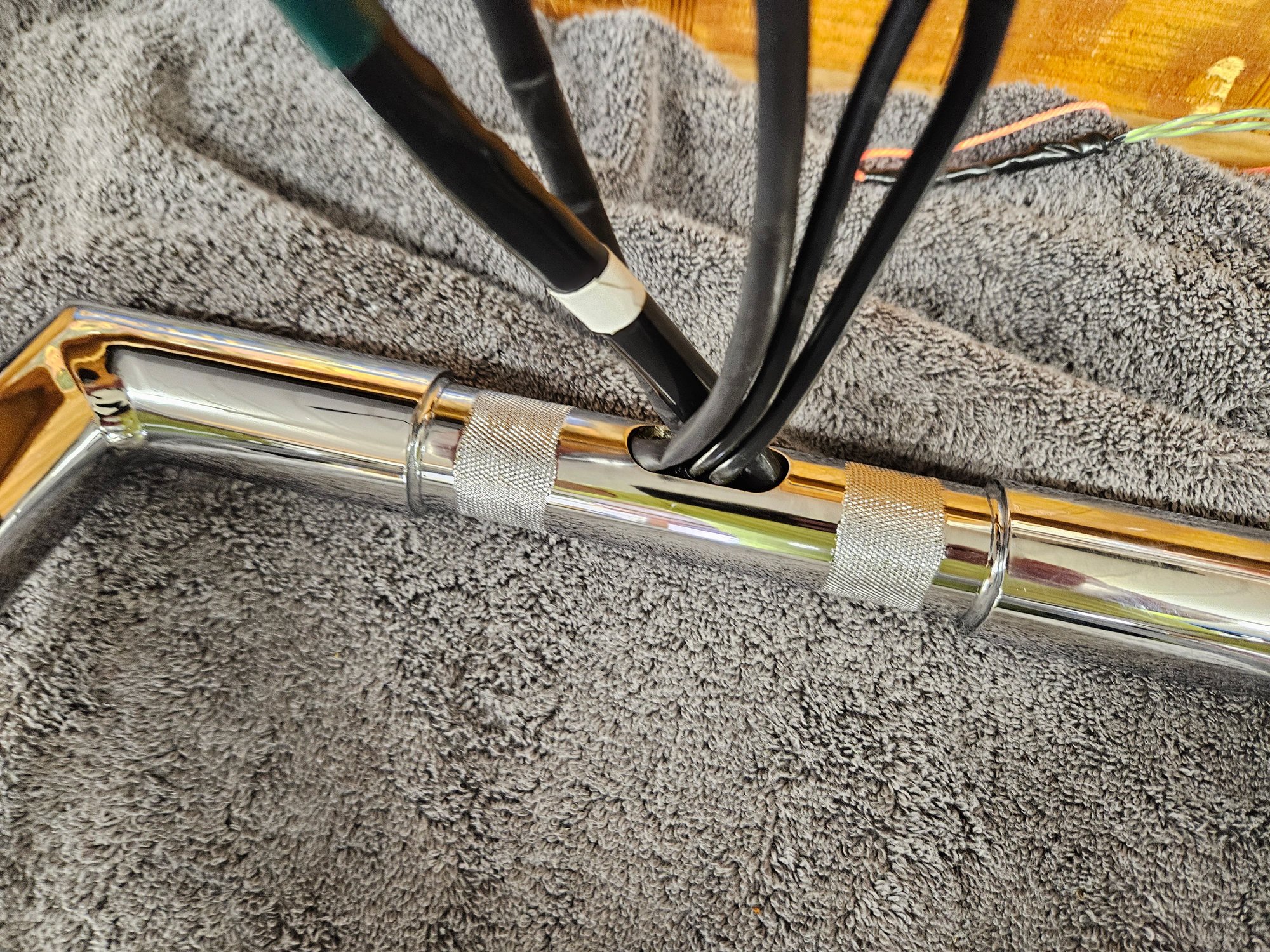

I have installed Five sets of bars now on 2016 and newer up to 2022 CVO and have not had to de-pin them. These include 10 inch, 12 inch, 14 and 16 inch.
Personally I think the de-pinning would be more work.
I just installed 16 inch LA Chopper Threshers and used Namz wires instead of stock so I did not have to add extensions.
Just take your time and remember it is a push and pull action to work them through.

I’ve installed the stock bars, H-D Tallboys, LA Choppers, and Khrome Werks bars on my 21 UL and the only time I’ve had to de-pin the connectors was for the Khrome Werks. The holes on each side for the controls wires are physically too small to push the connectors through. (Just the controls, the throttle and heated grip wires went in fine without de-pinning)
