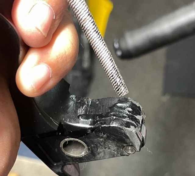

OP - I just did a redneck fix on mine this summer. My ‘16 Ultra Limited wouldn’t start unless in neutral. Cruise & gear indicator worked.
I was all ready to buy a new left-hand switch pack when I stumbled across a redneck fix. I can’t remember if it was on HDF or YouTube.
I filed a small trench in the clutch lever where it engages, the small neutral safety switch button. Just filing that **** flat didn’t seem to give me consistent results
So I looked at it some more and then took a rat file and put a small trench in there so the button could come all the way out. Repainted it semi gloss black and has been working right along.
It ain’t pretty, but nobody can see it.
