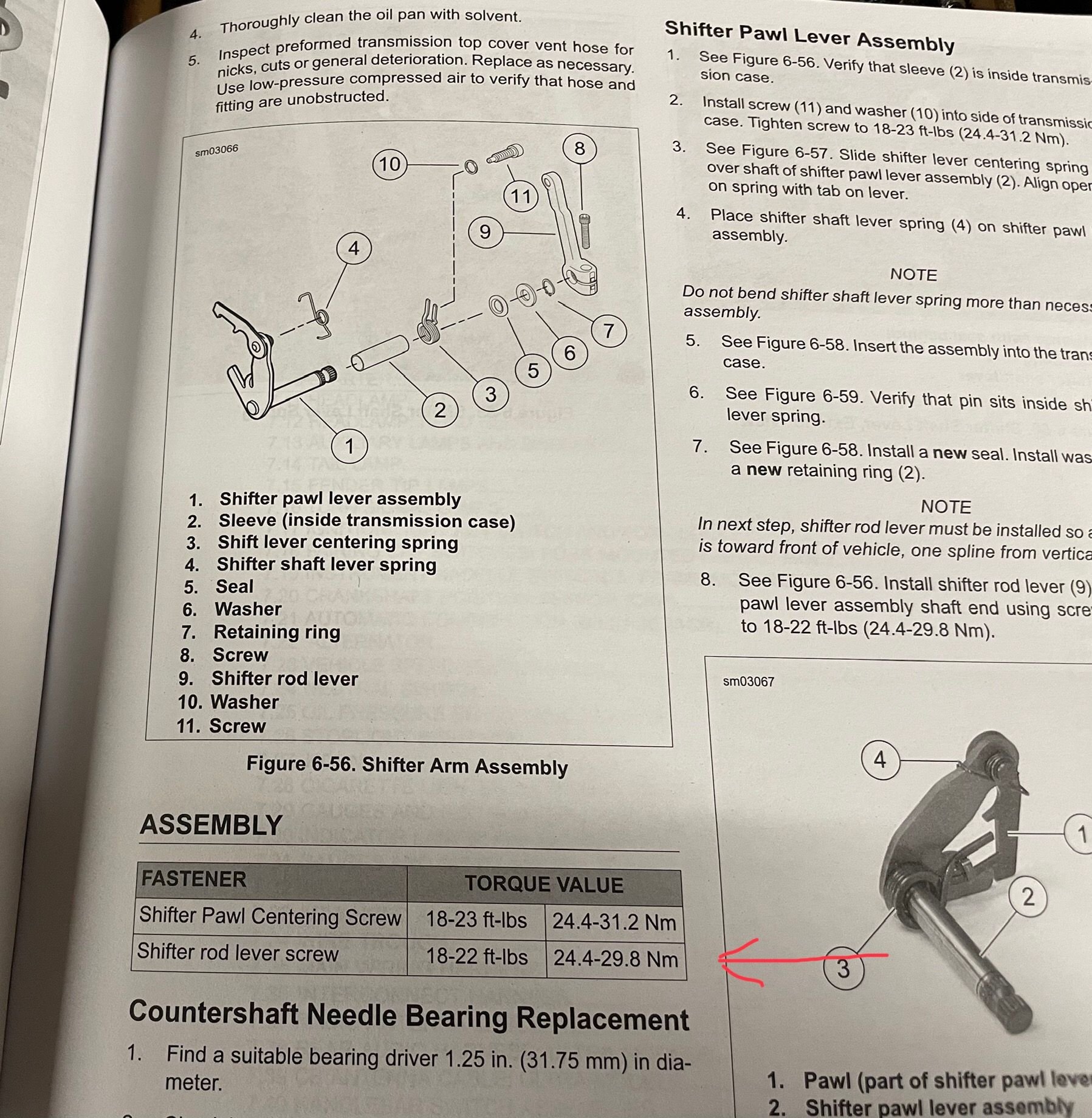

So did you break the bolt loose, clean the threads, do the blue, grease and washer? What torque are you using?
Not yet on any of that.
The first plan is to replace the bolt to see if i can clamp it tighter. I will use a new bolt, grease and washer and loctite. this is the cheapest and easiest fix.
I am using 22 foot pounds. That measure came from a YouTube video. I have a service manual and I cannot find any information on the shifter arm torque specs in my manual.
I plan to do the repair when cold weather arrives.
edit, I found the torque value in my service manual.
