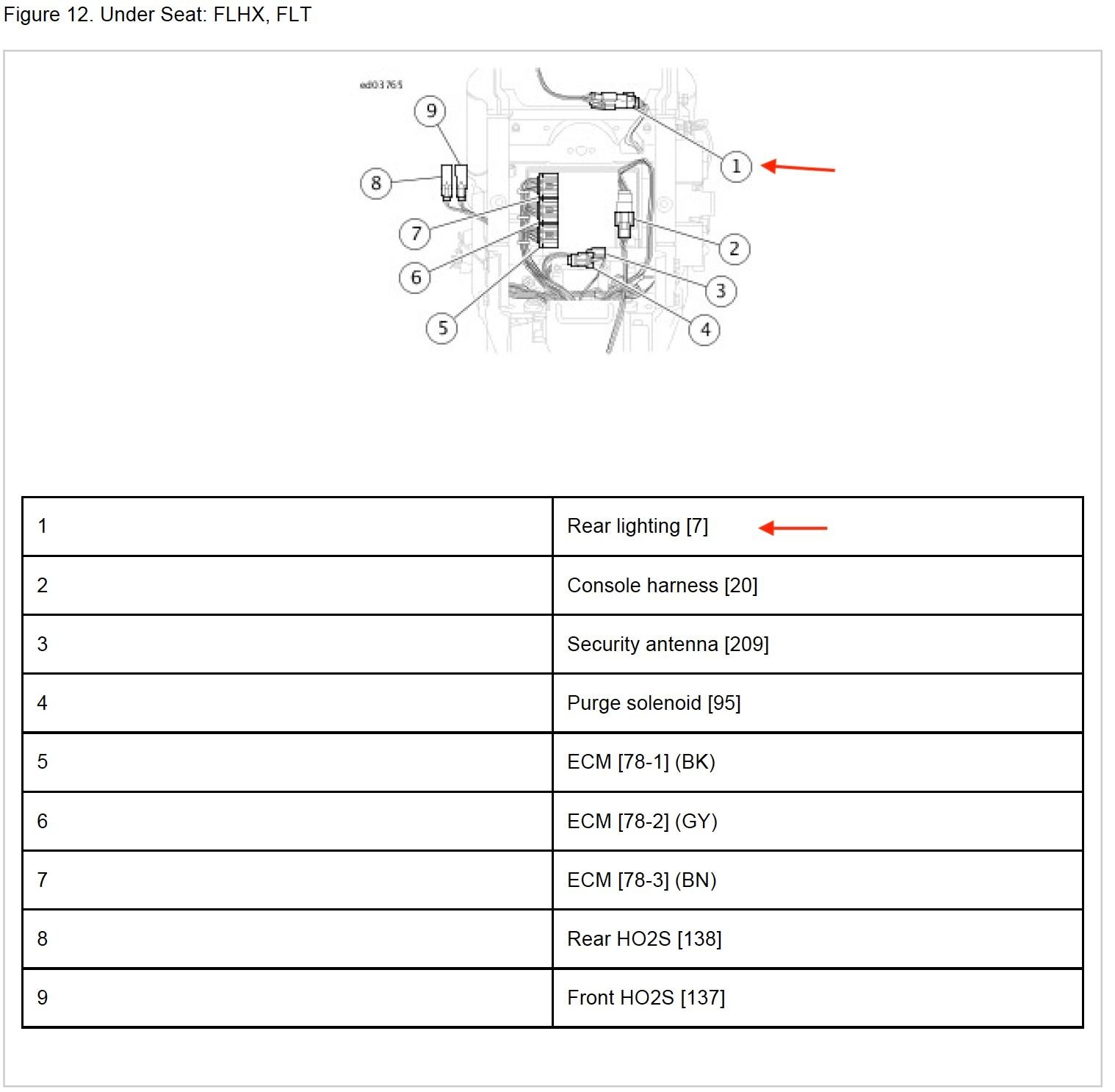

I don't have the 2020 Electrical Diagnostic manual, but here's from a 2018 (was the same on my 2016, and is in the same spot for my 2023), but its the same connector you would connect to if you were adding rear slot or bag lights. It's what runs to your rear fender lighting (run, brakes, turn)... now you just gotta figure out if the light will mount on the tour pack you want
FWIW, I have mounted the HD light bar for a King tour pack on both HD and Amazon (TCMT or something) Chopped tour packs no problem. It won't work on a Razor tour pack... Best to call the source of the tour pack and ask if the HD light bar will fit. Then most the aftermarket light bars (in case you do not want the HD light bar) are made to replace the factory HD light bar, so they are direct replacements (same hole pattern).

Thanks and I just got off the phone with Sheryl at Custom Dynamics (I’m liking their tri-bar matching wrap around) and she was exceedingly helpful.
She said the AM King tour packs are basically a mold of a mold so while there may be some minor discrepancies? Yes. They are the same basic profile for acceptable fitment.
