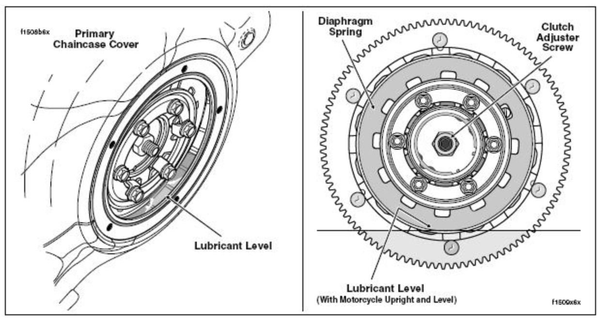

I was told to put 38oz into the primary on my street glide....i put 38oz of 80w-140 syn3(of which the dealership says is the new better oil,smh) and about 2 oz came out..should I redrain it and start over? Should it take less since it's thicker? Idk, just want a safe bike... Or just make sure it doesn't go over the pressure plate? Heelllpp 🙄

Welcome to the forum. Please explain, did you put 38oz in and then when you went to change it again, only 2oz came out of the drain plug, or did you put 38oz in and 2oz overflowed?

This is the appropriate way
Thickness doesn't affect volume.... 38oz of 20W oil is the same amount as 38oz of 60W oil....
If 2 oz. came out when it was filled with the bike upright, you have it way overfilled......
Hold the bike upright, or put it in a wheel chock, do not check/fill it on the jiffy stand.
Regardless of primary size (standard v Narrow or Touring v Softail), or oil weight, the above diagram from dawg shows how much to fill it...
2oz overflowed...it was on jiffy...leveled it and added more
