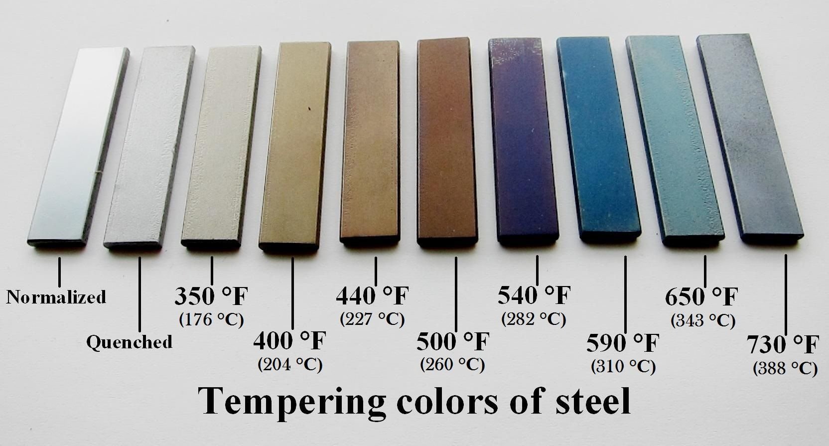

As said, completely normal. Even my black chrome has turned a little blue, and that's with a proper Fuel Moto tune. It's common in general, and more so with certain engine configurations.
Here you go:
