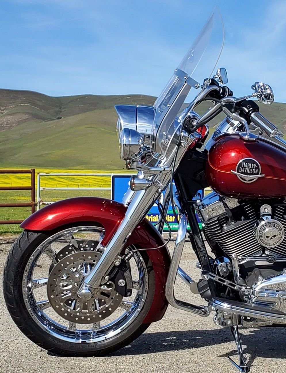

Freedom makes good shields. I have a ClearView, 17.5" Recurve, perfect height for me to see over yet not have any wind buffeting.

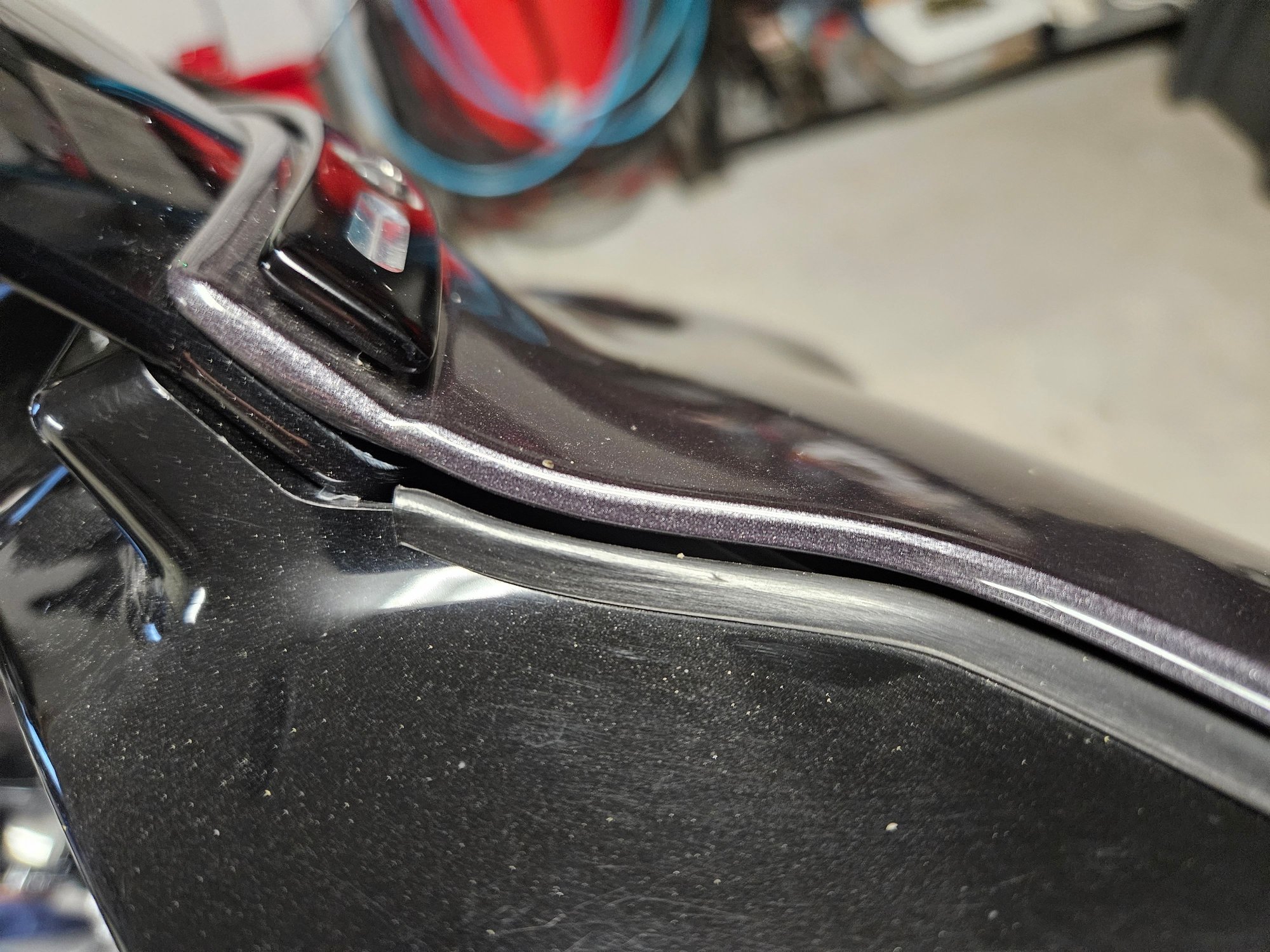

I put a Freedom Shield on my 14 SGS and it's been perfect. But I do have one concern. Because it is thicker than the stock shield, the fairing doesn't close up as tightly, and there is a gap on each side. I imagine over time dust can get in there and possibly water. I would love to hear other's thoughts on this.

Are you sure the windshield isn’t out of alignment. It looks like it’s not sitting flush in the recess of the inner fairing.
Try loosening it and pulling it up a bit. There is some wiggle room where the shield mounts to align it.
