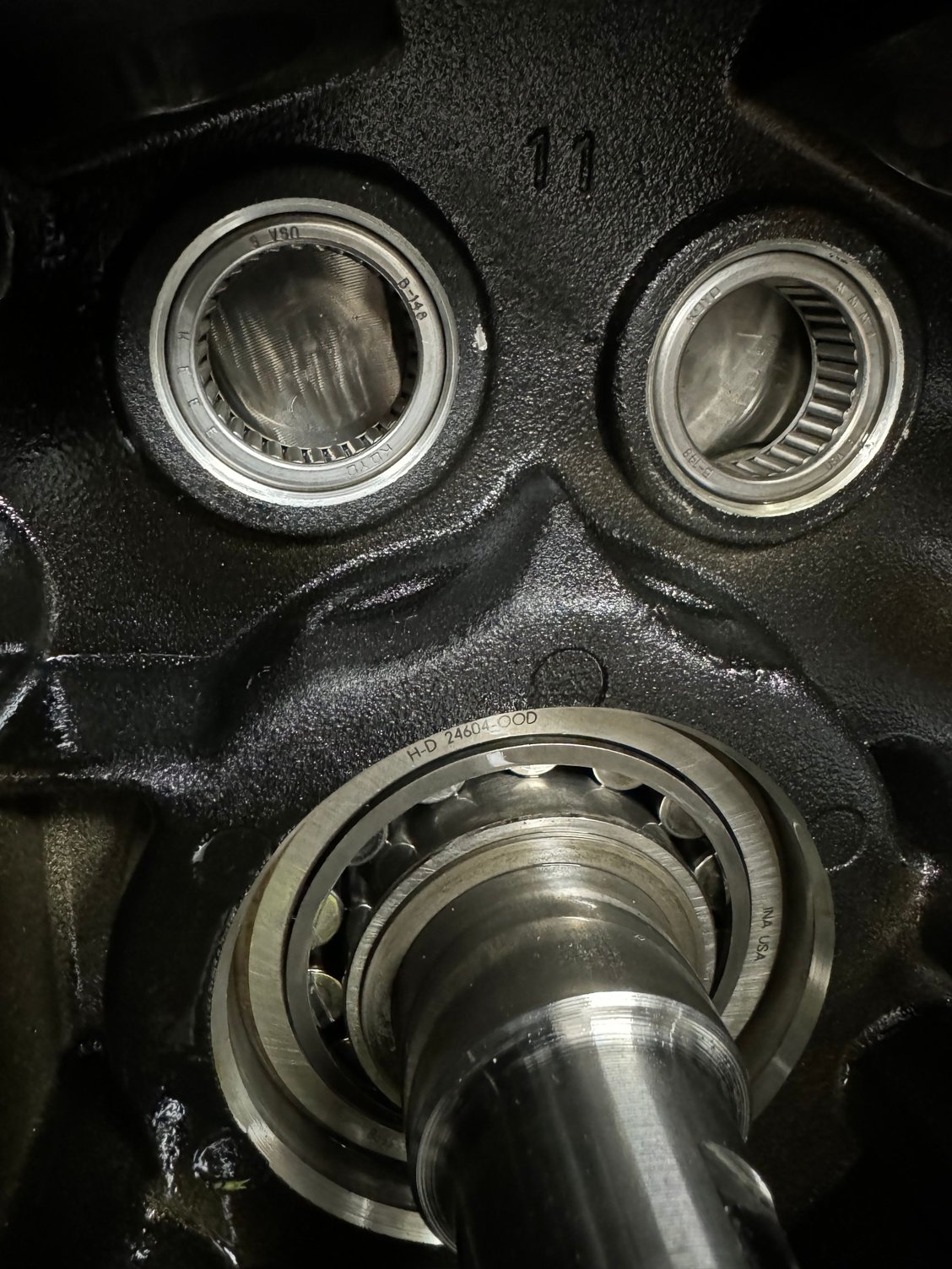

Inner cam bearing is a weak point. Mine failed at 77k and it wasn't pretty. (same year and model except it was an ultra.)

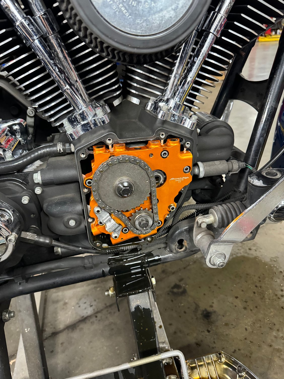

yea once it was torn apart it had the original inner bearings but someone had upgraded the cam plate with the screaming eagle plate and pump. It now has the koyo Torrington bearings now.

Yah, when I installed this kit I also upgraded the inner bears as above. Glad I did.

Let us know what you find in the cam chest... If the spring tensioners are OEM, and haven't broke up at 72K miles, I suspect your link-style chains are pretty smooth... I'd pop some Cyco tensioner pads on those spring tensioners and ride on...!
