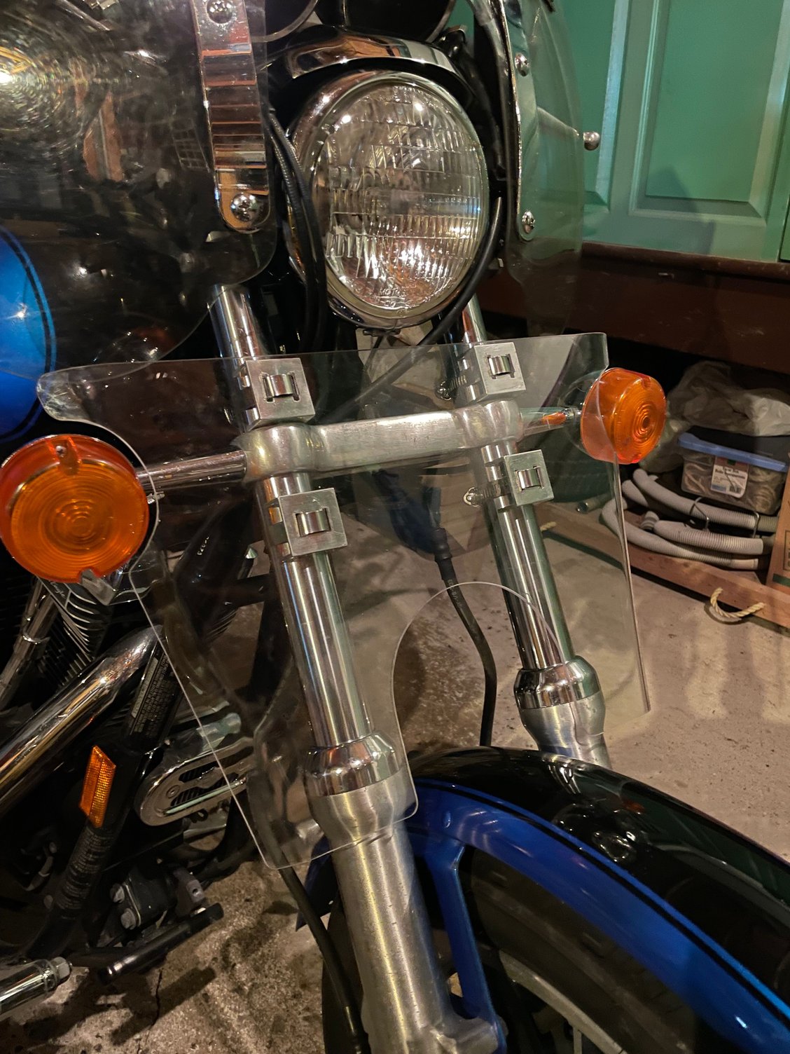

That's a perfect illustration of how the air envelope moves in your favour with the fangs. I first found out about the concept after looking on YT for some solutions to the buffeting on my '98 Dynaglide, where I have the top of my windscreen just below the horizon to my line of sight. I then designed a one piece to mount on the fork tubes, buying a 2 ft.˛ piece of 1/8" plexiglass from the local glass shop. I fabricated the saddles from aluminum 1-1/2" x 3" square channel, and then turned the curves over some large 3 inch exhaust tubing with a heat gun. The difference was significant, and was calmer than being in a convertible! It's important to curl the outer edges to impart necessary rigidity to the unit, otherwise it flutters too much with the vibration. I even had to cut off the lower legs of it as it was too unstable with them on.
