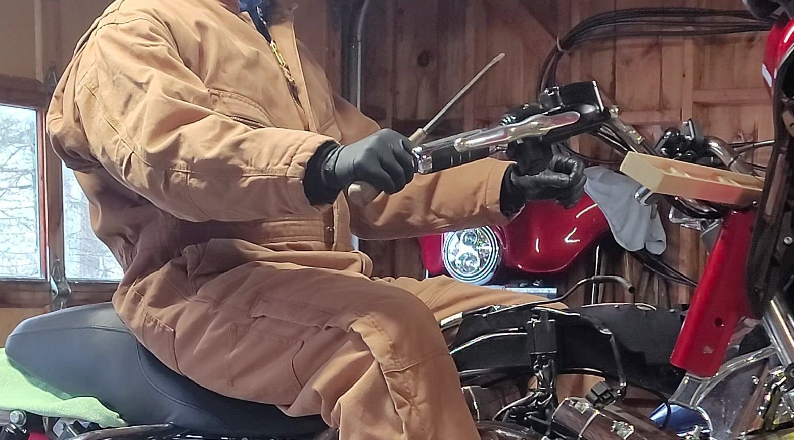

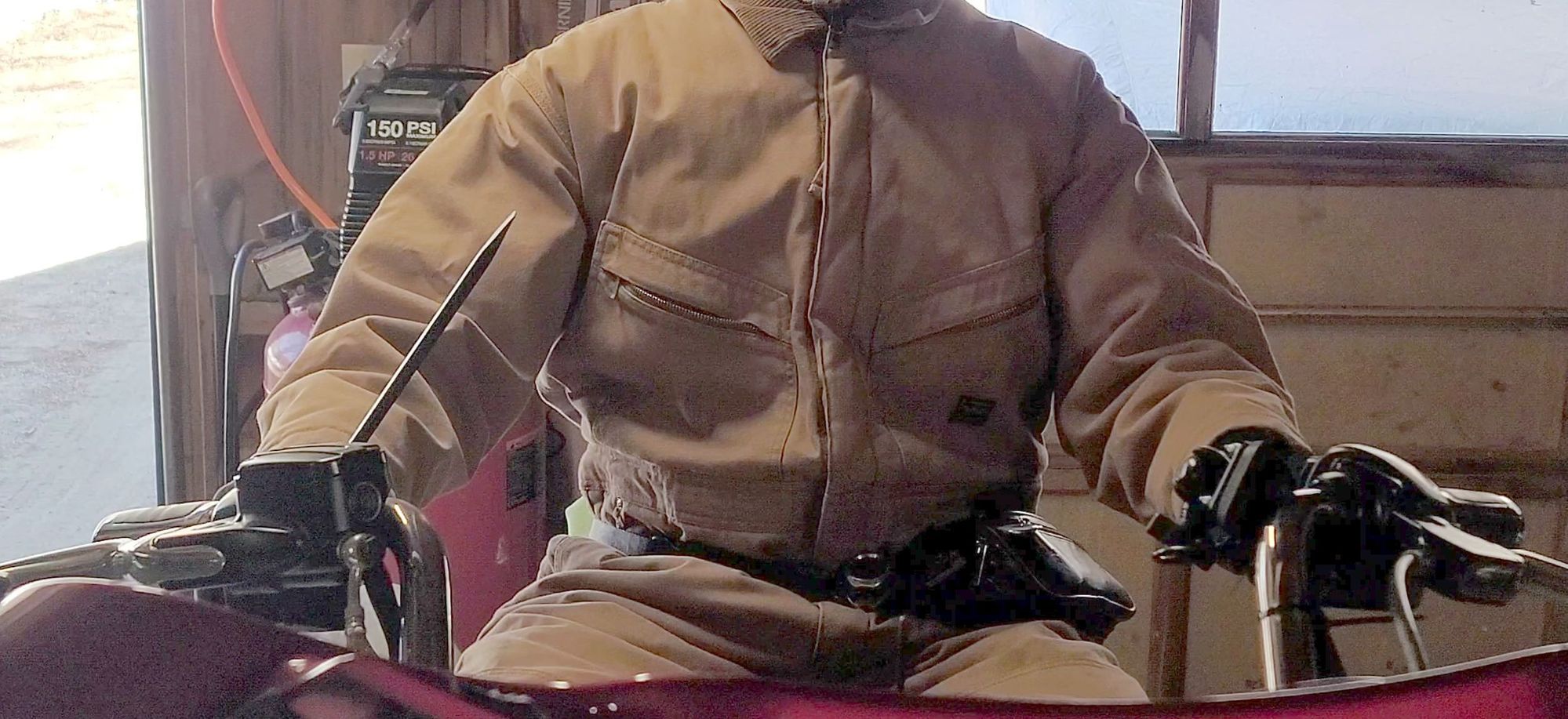

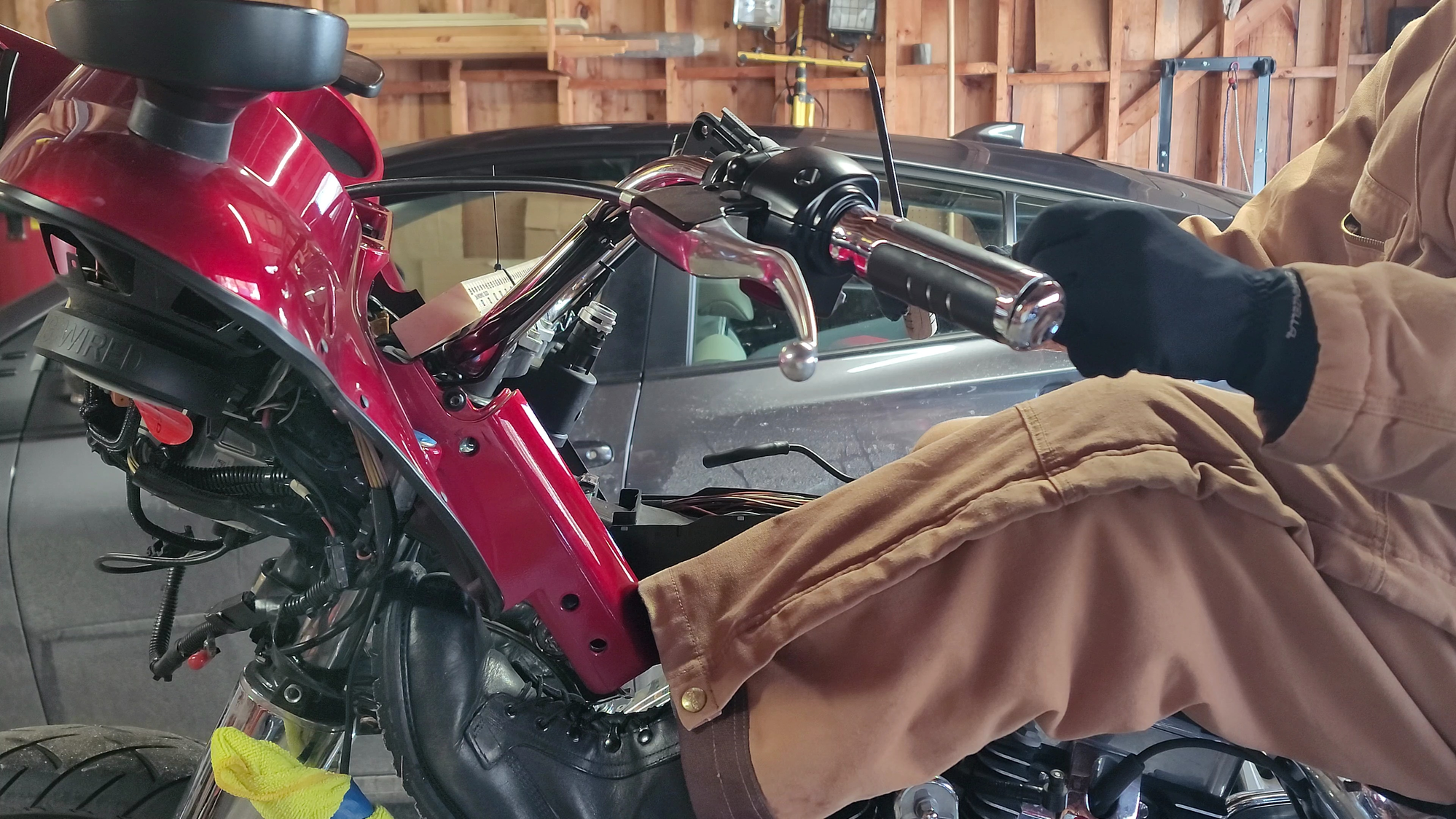

Buckhorns for Street Glide seem to be nearly impossible to find - most Harley buckhorns are for non-fairing bikes with much narrower mounting areas and/or 1" bars. After doing more research I took some pictures of about what I'm looking for in terms of seating position and handgrip placement, which appear below. Also did some measuring and it seems like I'm looking for about 17" of "Rise", and given how wide the SG bars are to start with, the front view makes it look like the new bars could just come straight back (no additional width), then the right angle on the handgrips does it. This would look a lot like apes do, except most apes curve the handgrip back out straight for some reason, where I want to it stay at that comfortable angle.
I've looked at BR Customs's Big Daddy's rounded top & bottom , Khrome Werks 16" Ape, and Handlebar Lee's Watermelon Bar. I couldn't find 1.5" Flanders bars.
Of those three, the KW Ape & HL Watermelon look more promising, as the KW doesn't straighten out the grips like most apes, and the Watermelon really looks kind of like a buckhorn. Sadly the image on HL's web site is literally the only one I've found, and it's not that great for figuring out how it would look on the bike. I was really hoping to find images on bikes but so far I've failed to see anything I'd call usable, which could easily my search foo is weak today.
Its seems like either of those handlebars could do if mounted low, pulling the handgrips back toward me, instead high up like most do. I may not have that classic "buckhorn rise" from the handgrip, but the reality is I'm not looking for that, I'm looking to improve my riding position. Both of them are likely to produce a wider bar than I want, and if that puts my hands outside the fairing I won't really like it. The KW Ape at least says it's 34.5", which is roughly the width of the stock bar, maybe a little wider.
Perhap I'll give BR Custom a try and see what they say. I'm not convinced a COTS handlebar is going to fit the bill, but I'm going to order something soon. I need lead time for manufacture and I've never changed a bike's handlebars before, so it'll take me four times longer to do that job. Spring Is Coming...
