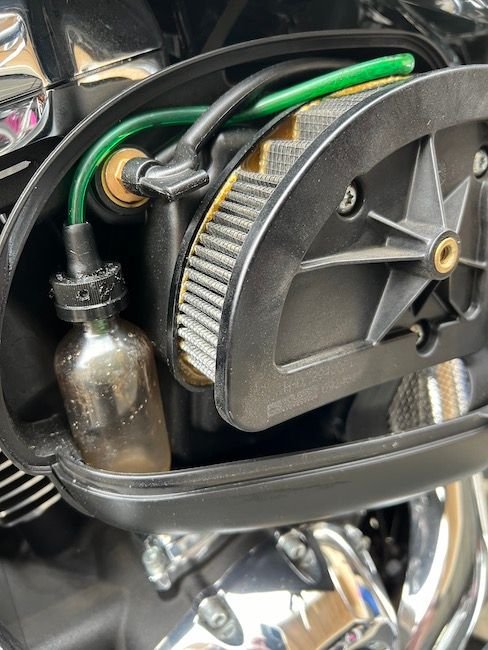

I really don't know but seems to me keeping this out of my motor and injectors would be better for for my bike. Maybe not? I don't think it's hurting anything by catching it. This was from about 300 miles this summer.
