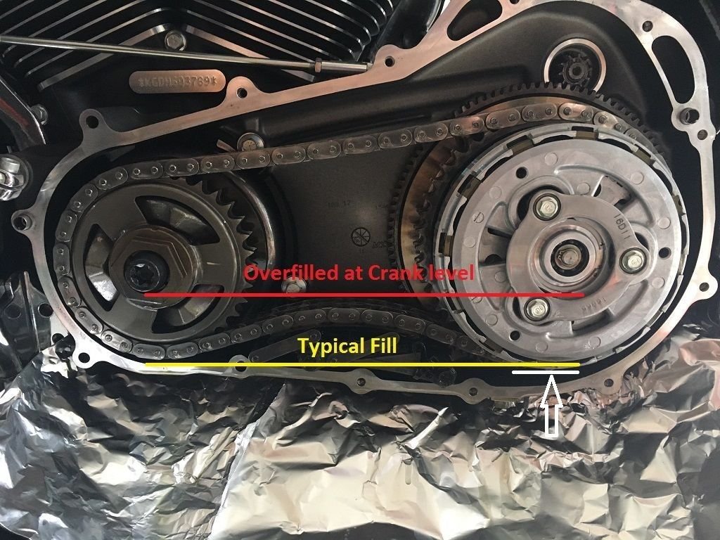

I would first try some Harley Davidson Formula + before tearing everything apart. Fill to bottom of clutch plates in accordance with the manual.

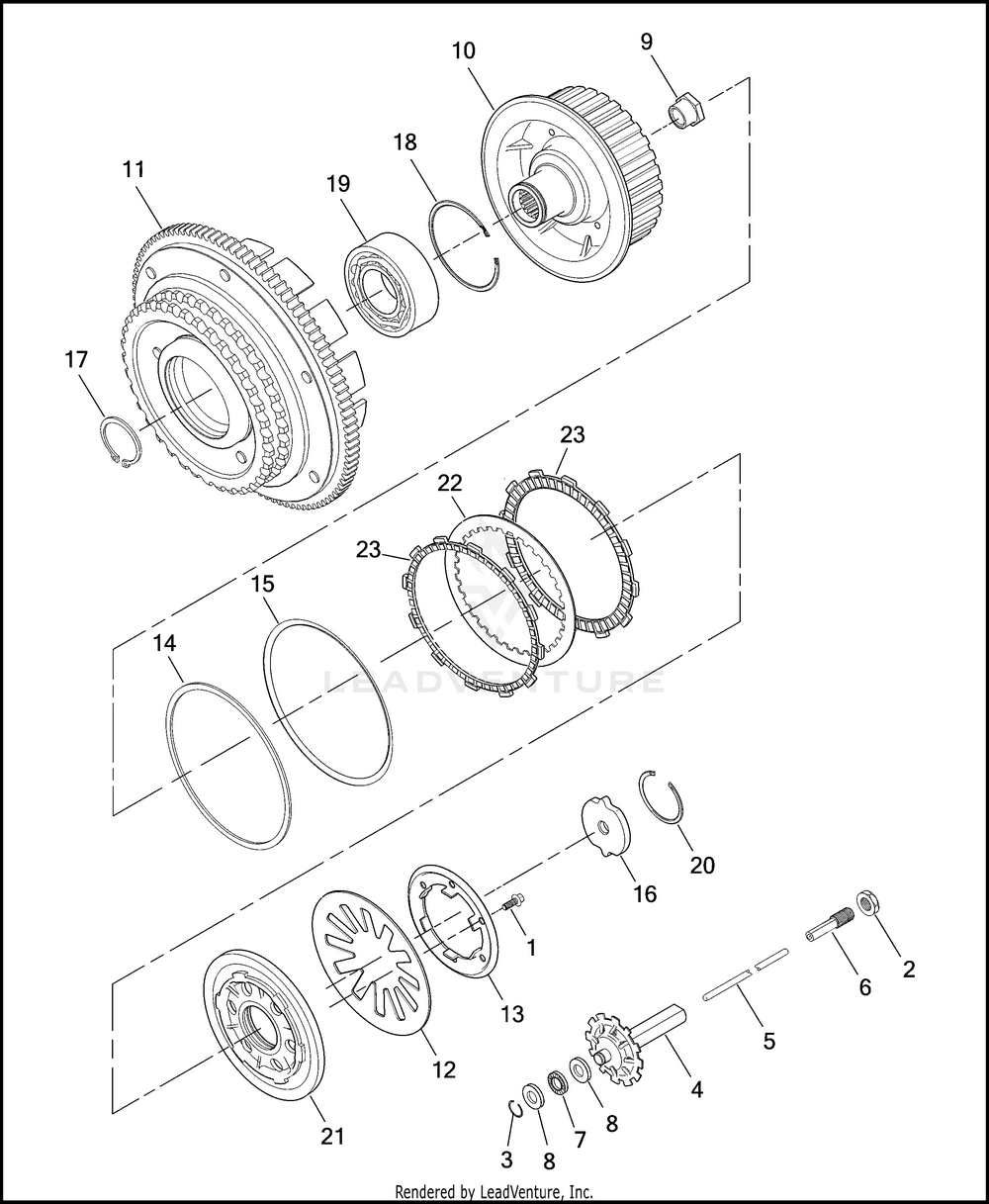

I've had the primary apart on this bike last year but now I'm starting to think I installed the clutch incorrectly with those little rings on the inboard side...

Well it is winter and if you have the time a good project to keep you busy. You can clean the fibers and steels with Brake Cleaner and inspect the tolerance per the service manual.
