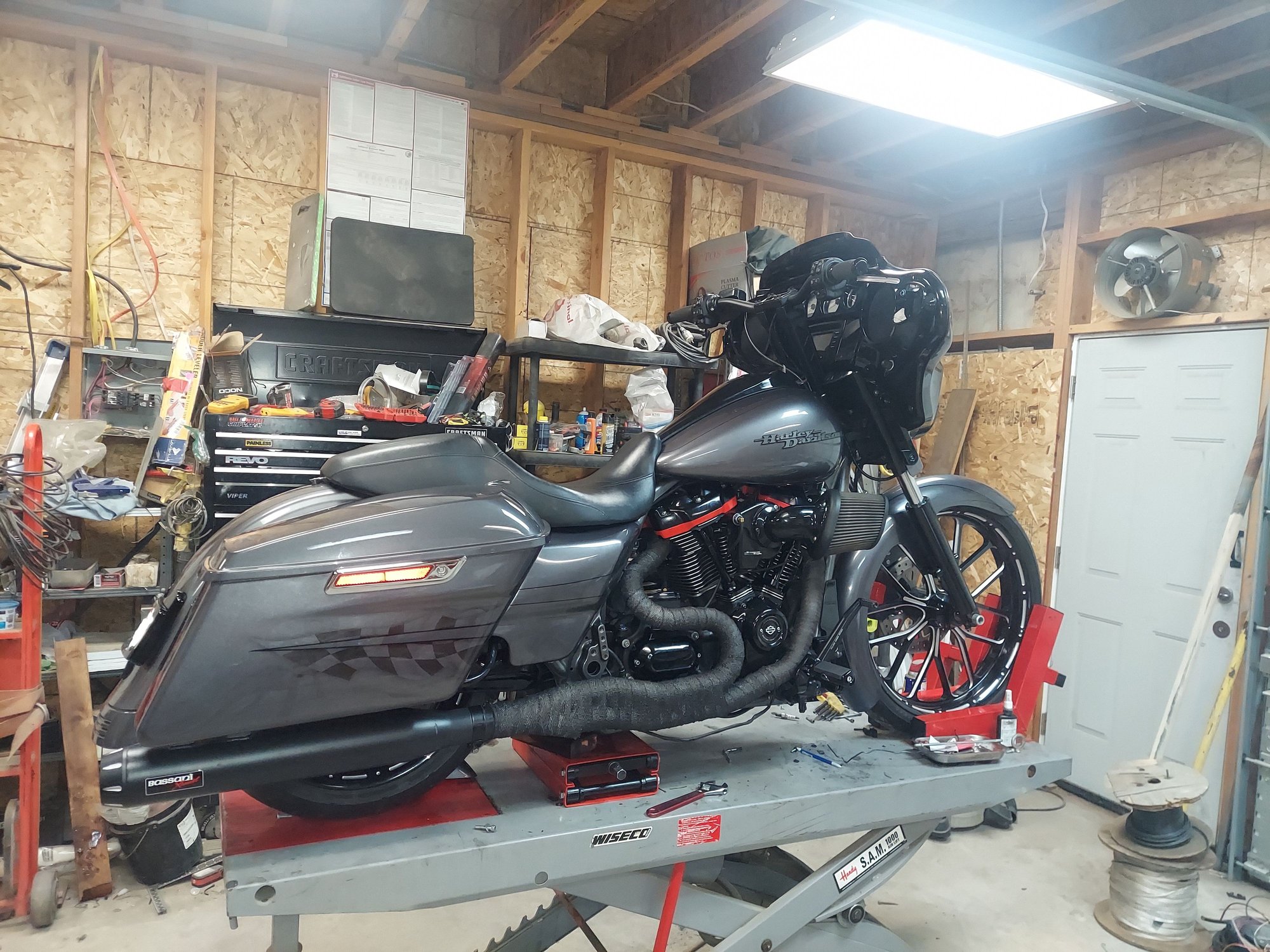

Originally Posted by simplegreen36
the bike is a 2014 SG witha healthy TC
I replaced all electronics with the exception of the gauges, there was no cutting or spicing necessary, as the harness was intended for this drive train
Nice!
How do you like that lift table?
